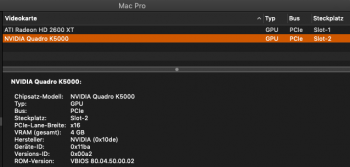

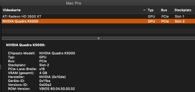

In the screen shot it can be seen, that the K5000 is recognized and identified but it says that no monitor is connected.
Any idea, what I need to do to activate the K5000?

I'm searching for a solution for some days to get the above mentioned configuration running.
I have a MacPro 3.1 with Mojave running for some time. I have the NVIDIA GTX 285 running in this setup. I used the Mojave Patcher from Dosdude1. I enabled also the Legacy Video Card option.
As I wanted to add new monitors with higher resolution I bought a used NVIDIA Quadro K5000 (non Mac).
It works when I start the MacOS X Restore but I don't get it working in the Mojave install.
The K5000 is currently installed in SLOT2 and I installed in SLOT1 the original ATI Radeon HD 2600 XT, because I cannot have both NVIDIA currently, because of the Power cables/requirements. I need to find a solution for that as well. But that's a different story.
As I said the 10.14.4 Recovery is activating the K5000 but not the Runing OS.
