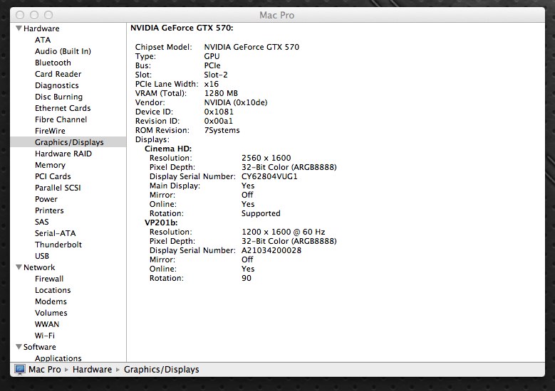

@mymacpro: not sure why you edited your previous post and removed the actual solution to my problem 🙂 I'm lucky that I got an email notification though.
Anyway your suggestion to try slot 2 seems to have fixed the issue.
The fan was indeed not spinning constantly when the GTX570 was installed in slot 1. The fan looked like it was trying to boot up (it spinned for a sec, and then no spinning for a a few secs). I replaced the card to slot 2 and all seems fine atm (at least the fan spins). I never heard this suggestion before, so I guess I owe you a beer for this great tip 🙂
Back to your edit mymacpro: will this setup cause me any power overloading in the future or not? Maybe MacVidCards has more experience on this matter.

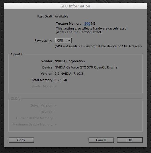

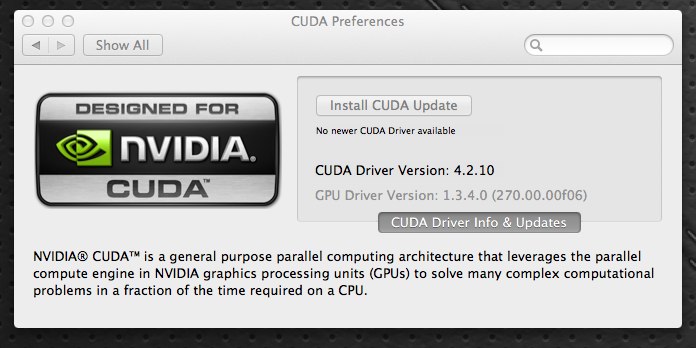

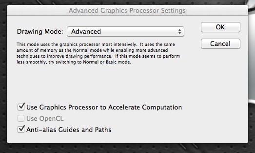

Now that I got the card working, I quickly glansed at the Photoshop CS6 settings, and notice the USE OPENCL is greyed out. In AfterEffects CS6 I cannot enable the GPU option, so I guess I'm still missing some drivers/fixes/hacks?

open cl is disabled by default in OSX for the nvidia GTX570. To enable it read here from netkas.org
http://netkas.org/?paged=2
You need to find the cuda_supported_cards.txt file that lists supported CUDA cards in it, and add:
GeForce GTX 570
to it. The GTX 570 isn't a known/supported card on the Mac platform for Adobe, so it's not listed in the text file (it is listed on the Windows version of the same software).

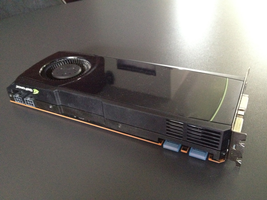

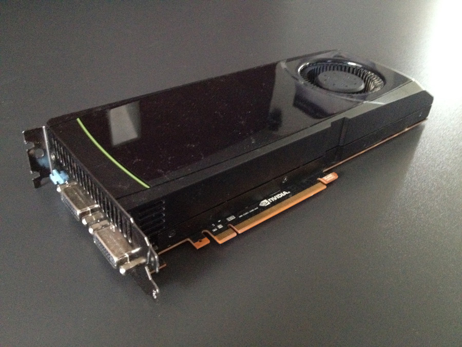

See attached photos for my 570 model. I guess it's the early model as you described it.
