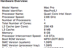

First off let it be known I would like assistance using the netkas flash method only.
System is a nice clean 2009 Macpro 2.66 quad with a GT120 GPU and 8 MB memory.
I was using the info from the iFixit web site as found here...
https://www.ifixit.com/Guide/How+to+Upgrade+the+Firmware+of+a+2009+Mac+Pro+41/98985
Downloaded the EFI.dmg file and the netkas update tool. Followed the very simple instructions, but each time the update starts normally, I get a brief update bar on the screen then the system fails and does a reboot back to the desktop.
Tried a different GT120, changed video cables and swapped monitors, all to no avail.
Am I missing something here, this is an upgrade that has been done successfully by many - hundreds of users on 2009 MacPros.
Surely mine's not destined to be the first to not work.
I know it's in the guide, but If El Capitan or newer make sure you disable SIP.
If that's not it, what firmware are you currently on? You need to update to the latest 4,1 firmware

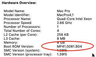

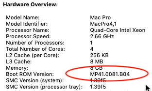

What's our current BootROM version?
This what you need?
