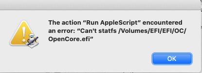

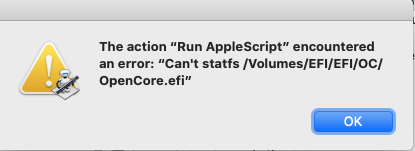

I updated my 5,1 from Mojave to Catalina a couple of years ago. Now I want to go to Big Sur. I need to be able to update software.
I'm trying to use the Clover Configurator workflow but am having trouble.
I've confirmed my Boot ROM is 144.0.0.0.0. I am unable to launch in Recovery Mode. I've tried everything other then a reinstalling Mojave. I can see the recovery volume on my system drive. I disabled the SIP and when I enter csrutil status from terminal the status reads: unknown (custom configuration) though each individual configuration is listed as disabled.
I went ahead and launched the Clover Configurator. Everything seemed to go fine until I blessed it where I got ther error message Run AppleScript" encountered an error: "Can't statfs /Volumes/EFI/EFI/OC/OpenCore.efi"
I turned off Clover Configurator and Catalina seems to still be running OK. Sure would like to get to Big Sur though.
Any thoughts appreciated.

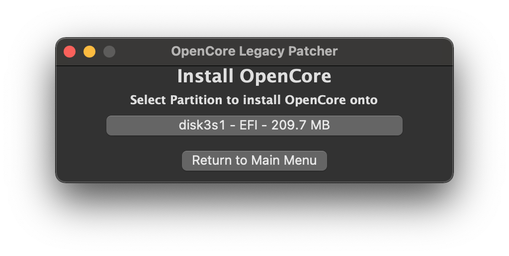

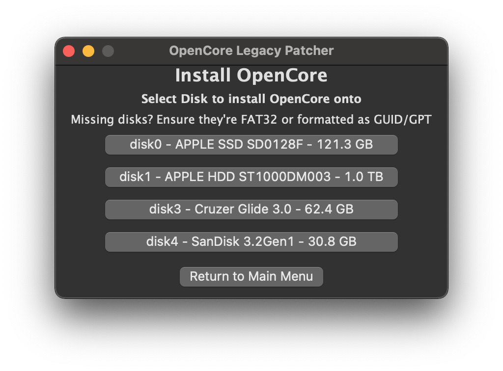

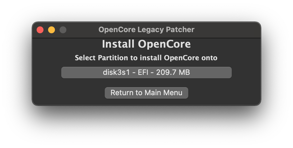

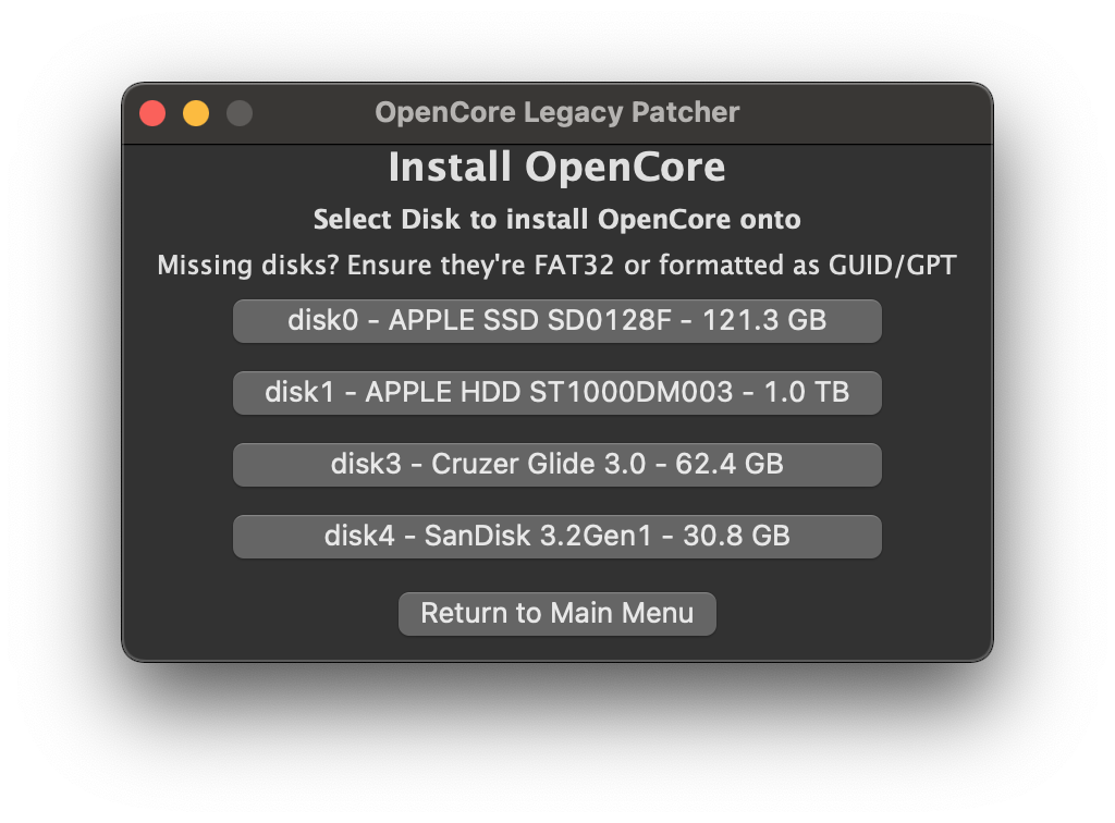

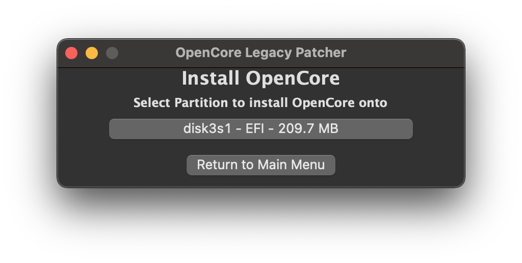

To bypass USB booting you have to install OpenCore within OCLP exactly like you did for your USB drive, but selecting the boot drive instead (the one with the fresh Big Sur install).
Here you select your INTERNAL boot drive: A81C126C-9CC7-4A12-8D20-D483356D9A75.png
And here your EFI partition on your internal boot drive:
Obviously your drive names and sizes will be different from the screenshots above.
Here you select your INTERNAL boot drive: View attachment 2166409
I got to this and it stopped me. The warning that the system drive needs to be either FAT32 or GUID/GPT stopped me. I didn't get the message that APFS formats were GUID formats. Looks like I'm good to go. Thanks for your help.

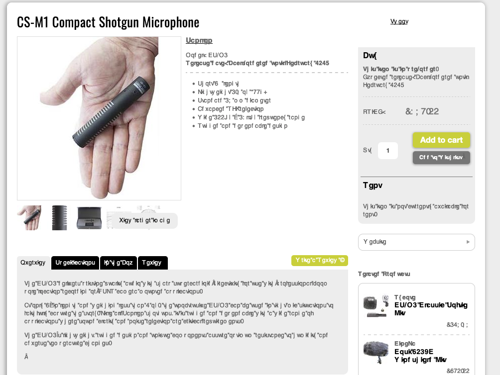

Well everything's been going really well... just one thing that I don't understand. When I'm on the internet sometimes the writing is changed into a different language/code/???. Not sure what's happening but it's consistent. What is happening and is there a fix? Again, thanks!
