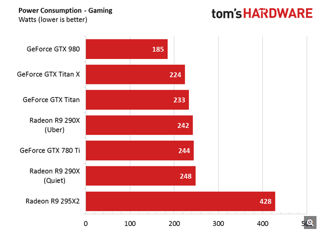

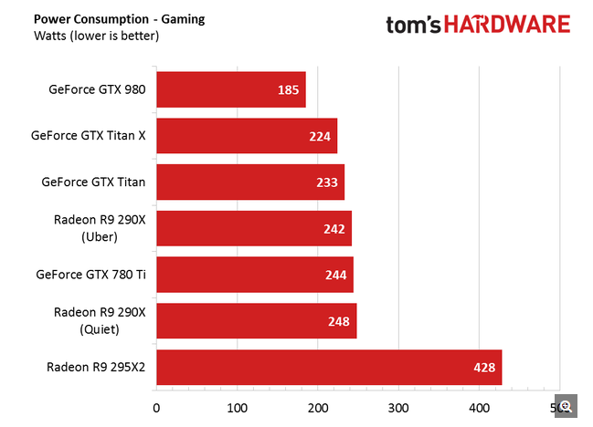

In gaming the GTX Titan X draws maximaly 224 watt. I guess it's the same with the GTX 980 Ti.
Only with torturing it draws up to 250 watt.
http://www.tomshardware.com/reviews/nvidia-geforce-gtx-titan-x-gm200-maxwell,4091-5.html
