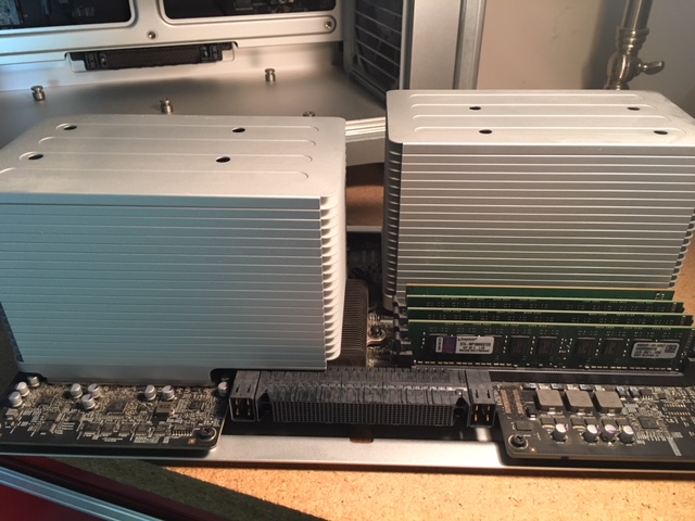

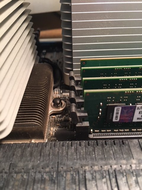

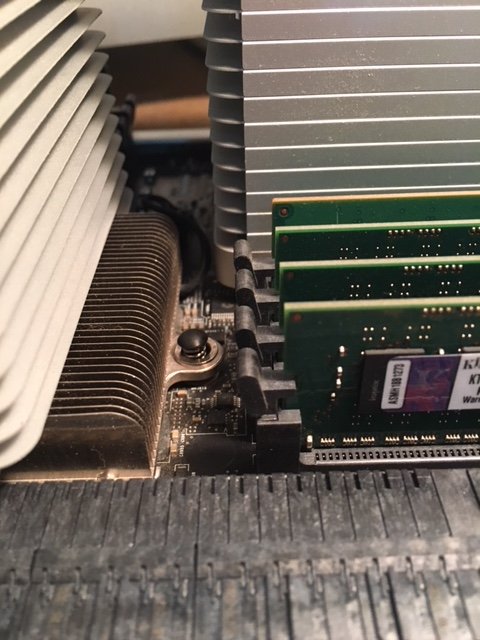

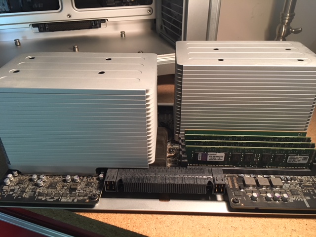

Pull out the CPU tray, check the north bridge heatsink and the associated rivet. For dual processor model, it's very easy to check it.
Just checked it. Looks good to me; but have no reference point.... here are a couple pics
photo.php
photo.php
It was dusty as heck though. I cleaned it up... would be nice if that would fix it😉
photo.php
photo.php

The rivet still there and the heatsink seems still "stick" to the north bridge. So, I will still assume the biggest suspect is the PSU.
