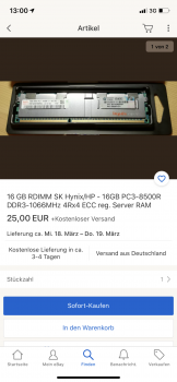

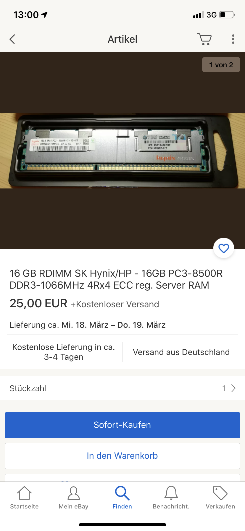

Okay, for me is this a sign that the memory module from slot 1 is destroyed so I have buyed two new memory modules. But, if I install this two modules into slot 1 and slot 2 the white power LED on the front of my Machine flashes if I power on the machine. The same if only one new memory module ist installed (in slot 2, slot 1 empty).
Have i buyed the wrong memory modules?🙄

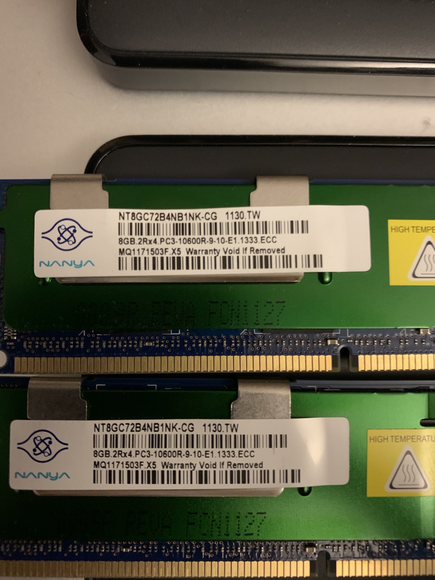

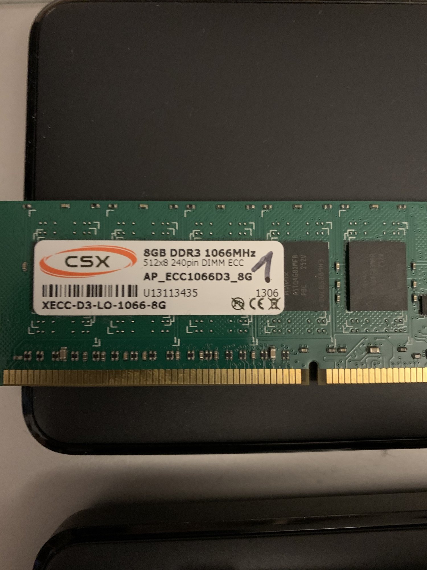

Old memory modules (4 pieces installed in my Mac):
New memory modules (2 pieces for slot 1 and 2):

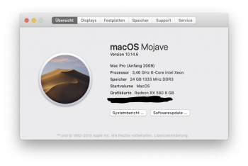

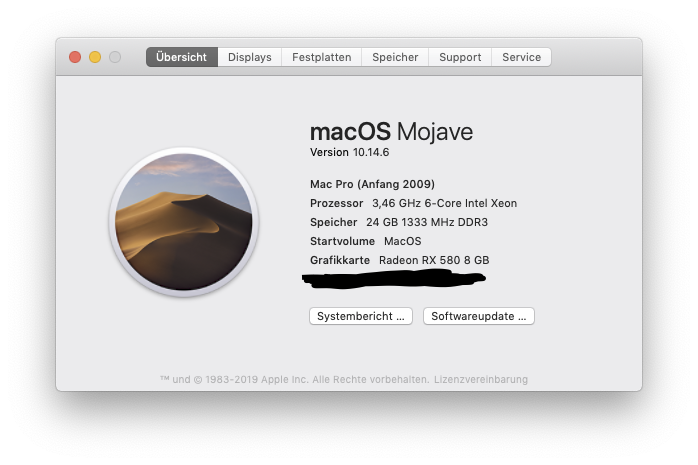

My Mac:

Please note that the best memory performance possible will be 3x16GB RDIMMs, Nehalem and Westmere Xeons are tri-channel and using 4 DIMMs have some penalties with memory access.
If you have an application that works best with more memory than faster memory, use all 4 DIMM slots, while if you have an application that works best with faster memory than more memory, use just 3 DIMM slots.
Okay, thank you! Then i will change the buyed memory modules and buy 3x16gb RDimm 😬
Dual rank only. Read the memory thread and see the models that are known to work.
Reactions: Chrisf1977
get three of these and you'll be happy :
16GB = Samsung M393B2G70BH0-YH9 (low voltage) .
For a total of 48GB at 1333 MHz .
Remove all other ram from your System first .
