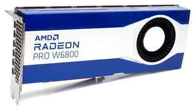

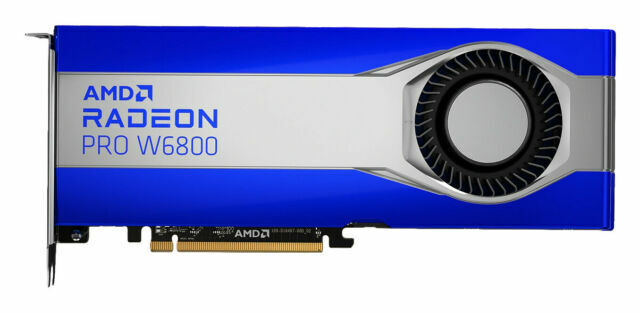

Here is one candidate:
Total Board Power (TBP)250W Peak

Do you know about the W6800 as it would fit perfectly?
