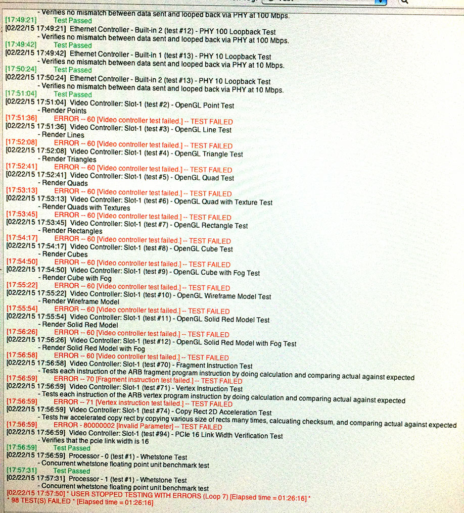

I have a bunch from the other day that happened pretty much in a row and some from a couple weeks ago before I sprung for a new power supply.
All KPs are GPU related. Try to switch to OS X built-in drivers for a day or two and see if it will change anything.
No dice, MP just took a big dump while running OSX drivers.

Update.
I ran both EFI and OS ASD Hardware tests for 12 hours each.
EFI returned no problems.
OS Tests came back with a ton of GPU errors and then the machine refused to boot, tries booting for over an hour.
However I started to strip the machine down one thing at a time.
I removed my blackmagic 4k card and tried booting and it started immediately. So I am hoping that is the issue. I will run the hardware tests again and see if they persist. Is it possible my blackmagic card was messing with my GPU and causing it to fail?
Here are the results from my the OS ASD tests.

Well I am still getting the same errors with the ASD with the blackmagic card removed. However this is a 10.6 test and the GTX680 wasn't out yet so it simply may not know how to test it.
[19:35:13] ERROR -- 60 [Video controller test failed.] -- TEST FAILED
[02/22/15 19:35:13] Video Controller: Slot-1 (test #3) - OpenGL Line Test
- Render Lines
[19:35:46] ERROR -- 60 [Video controller test failed.] -- TEST FAILED
[02/22/15 19:35:46] Video Controller: Slot-1 (test #4) - OpenGL Triangle Test
- Render Triangles
[19:36:18] ERROR -- 60 [Video controller test failed.] -- TEST FAILED
[02/22/15 19:36:18] Video Controller: Slot-1 (test #5) - OpenGL Quad Test
- Render Quads
[19:36:50] ERROR -- 60 [Video controller test failed.] -- TEST FAILED
[02/22/15 19:36:50] Video Controller: Slot-1 (test #6) - OpenGL Quad with Texture Test
- Render Quads with Textures
[19:37:22] ERROR -- 60 [Video controller test failed.] -- TEST FAILED
[02/22/15 19:37:22] Video Controller: Slot-1 (test #7) - OpenGL Rectangle Test
- Render Rectangles
[19:37:55] ERROR -- 60 [Video controller test failed.] -- TEST FAILED
[02/22/15 19:37:55] Video Controller: Slot-1 (test #8) - OpenGL Cube Test
- Render Cubes
[19:38:27] ERROR -- 60 [Video controller test failed.] -- TEST FAILED
[02/22/15 19:38:27] Video Controller: Slot-1 (test #9) - OpenGL Cube with Fog Test
- Render Cube with Fog
[19:38:59] ERROR -- 60 [Video controller test failed.] -- TEST FAILED
[02/22/15 19:38:59] Video Controller: Slot-1 (test #10) - OpenGL Wireframe Model Test
- Render Wireframe Model
[19:39:31] ERROR -- 60 [Video controller test failed.] -- TEST FAILED
[02/22/15 19:39:31] Video Controller: Slot-1 (test #11) - OpenGL Solid Red Model Test
- Render Solid Red Model
[19:40:04] ERROR -- 60 [Video controller test failed.] -- TEST FAILED
[02/22/15 19:40:04] Video Controller: Slot-1 (test #12) - OpenGL Solid Red Model with Fog Test
- Render Solid Red Model with Fog
[19:40:36] ERROR -- 60 [Video controller test failed.] -- TEST FAILED
[02/22/15 19:40:36] Video Controller: Slot-1 (test #70) - Fragment Instruction Test
- Tests each instruction of the ARB fragment program instruction by doing calculation and comparing actual against expected
[19:40:36] ERROR -- 70 [Fragment instruction test failed.] -- TEST FAILED
[02/22/15 19:40:36] Video Controller: Slot-1 (test #71) - Vertex Instruction Test
- Tests each instruction of the ARB vertex program instruction by doing calculation and comparing actual against expected
[19:40:36] ERROR -- 71 [Vertex instruction test failed.] -- TEST FAILED
[02/22/15 19:40:36] Video Controller: Slot-1 (test #74) - Copy Rect 2D Acceleration Test
- Tests hw accelerated copy rect by copying various size of rects many times, calcuating checksum, and comparing actual against expected
[19:40:36] ERROR - 80000002 [Invalid Parameter] -- TEST FAILED
[02/22/15 19:40:36] Video Controller: Slot-1 (test #94) - PCIe 16 Link Width Verification Test
- Verifies that the pcie link width is 16
