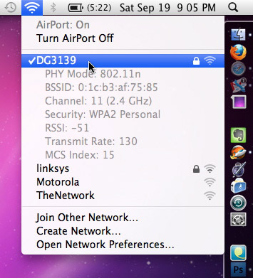

Hold down your 'option' key while clicking on the Airport icon in the Finder. Then tell us how you are connecting to the wireless router.

I did that to check the info it shows; what specific info is the thing to watch? I have a dual band router that I can use either the 2.4 or 5 GHz bandwidth. Neither seemed to work properly.
Here's a sample (not mine) as I am not able to access my mac at home right now.

The picture you shown shows that that Mac is using the crowded 2.4 on channel 11. So if you have a dual- band router go into the router and change your 5 Ghz channel to the hundred range to get the true 5 Ghz speeds.

OK; when I initially connected to the 5GHz band, I was auto-assigned channel 36, but you're saying to set a defined channel at the 100 range? I'll try that too.
OK, pretty sure the card is bad… I changed the router channel to 149 in the 5GHz range, made sure the card was seated nicely in place; antenna wires were in the Apple directed spots and the same thing happens. Sys Info sees the card as a/b/g/n just fine, finds my network and joins, connectivity immediately to load up a page, then performing a "net speed test" instantly drives the bitrate into the ground and loses the network and cannot reconnect without a restart.
