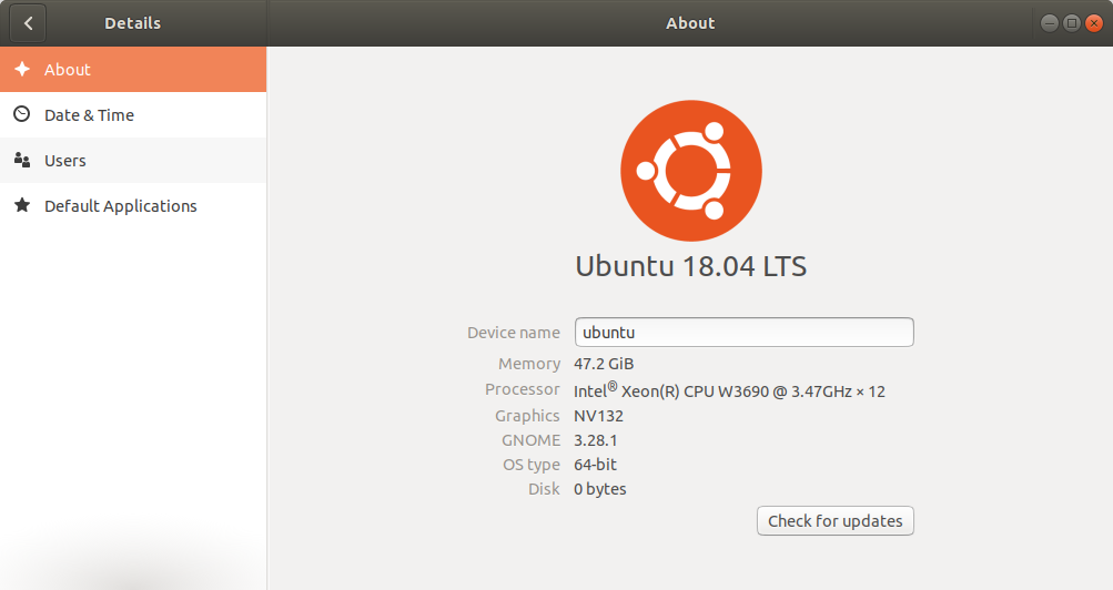

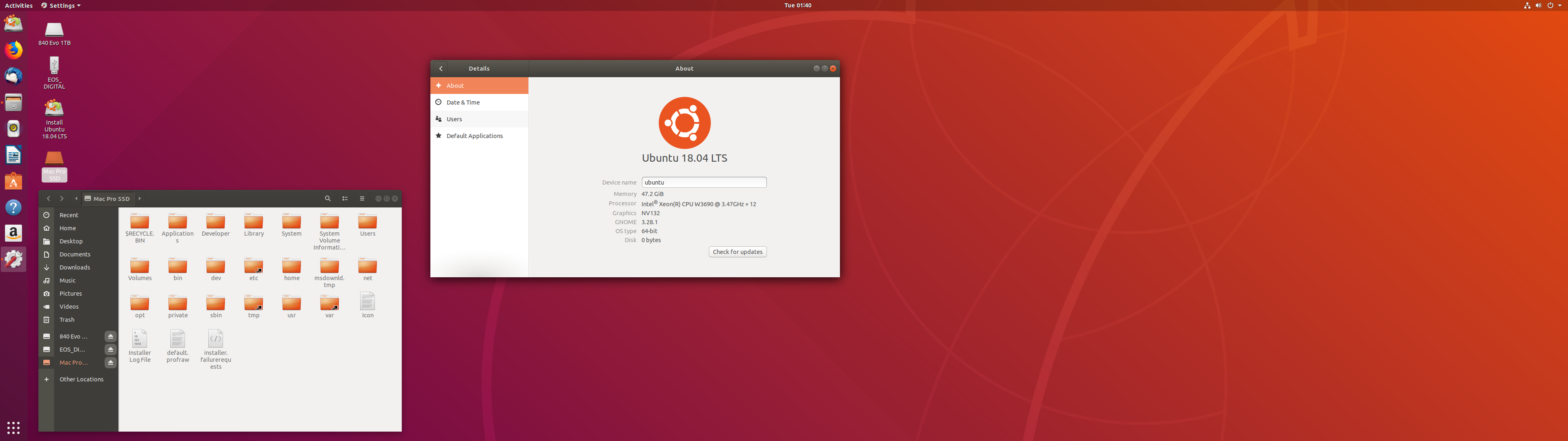

Good to hear that.
Anyway, just finished the test. Of course, the result is "can boot Ubuntu Live CD" 😀
