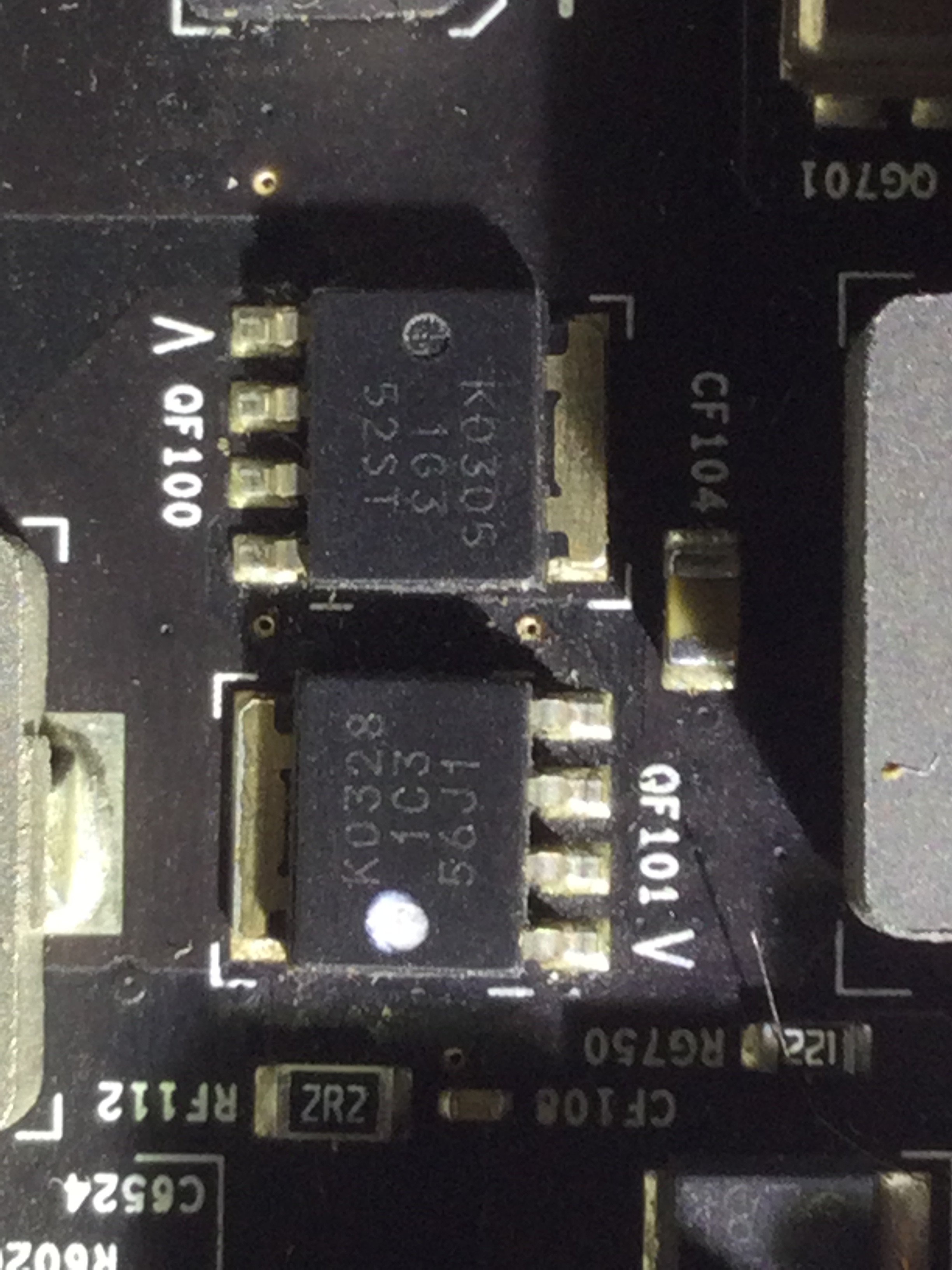

I have a faulty CPU board on the above MacPro. The computer shuts down when pushed very little.
I've taken the CPU's out and checked the board. All I've found so far is ,black 330 e17 caps that are testing short and what looks like a mosfets or regulator thats testing short on three legs and to the back also. Has four legs in total. That bits quite small. Has anyone had any success in repairing these boards. Looks like a hot air job. Maybe remove some nearby silver caps beforehand.
I have two like this altogether. They both did it ,one after the other. I swapped to the one I'm using now and it's very similar in how it behaves. This one is 2 x 3.46 but you wouldn't think it ,at all. I've not checked the board on this one yet ,It might be the same problem.
I'll post a photo later on. The part isn't surrounded so that might help in removal and installing another one ,if I can get it.

Looks like the left 3 pins of that mosfet are joined internally so its not that at fault.
I just ordered the Mosfets. I got the other one aswell just in case.
I'll be happy if I get these two macs sorted. One at a time though.
I reckon I could remove them with two soldering irons. I'd prefer that way.

I am having similar issues , the second mosfet showed short-to ground , I pulled it but now I'm stuck wondering if it's fixable or may have other burned/problematic parts on the tray... (In theory I should buy 4 mosfets , that are not so cheap to finish my work , with the risc that I need to fix other parts also - currently unknown - I don't like volt-injection but I do like checking with multi-meter.)

What happens is the Ram seems to not be recognised on CPU A when the computer has been on for a while. I turn it off for a while then it comes back. I even swapped the Ram over. Same thing. When I do anything of any demand the computer can shut down. It’s all related to CPU A. I’m not going to do anything until I’m sure what it is. I was actually wondering if it was the power supply. Or related to power in some way. Could be caps on the board. They’re not testing short anyway.
Those mosfets can test short because the circuit has a very low resistance. Be careful of that.
