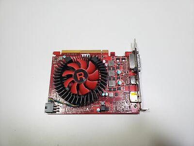

Biostar OC Gaming Radeon RX 560 4GB GDDR5 128-Bit DirectX 12 PCI Express 3.0 x16, DVI-D Dual Link, HDMI, DisplayPort and Vortex Dual Cooling Fan​
would this be compatible?
