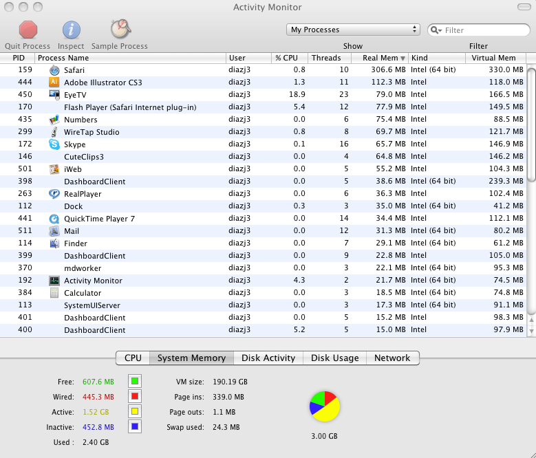

about pageouts, I'm not too familiar with the concept. I assume it's the blue area on the graph?... here is a screenshot of my activity monitor, the way RAM is about 75% of the time. Usually I have around 10-20% "free" memory at the end of the day before I shut it down (somehow used RAM is more as the day goes by)... Only 25% of my time I do what you'd call "intensive" work on it - and those times I have no problem in closing other apps to free up memory.
So I figured that - if on average I'm using 75-85% of the original 3GB RAM... getting (3x2GB sticks) 6GB (optimizing RAM with 3ple channel) will be enough to have 30-50% of RAM free on average days.... (thus, avoiding pageouts?)... does this make any sense?
PS. about the HDD questions: are these "server grade" F1 Samsungs worth the extra 50% markup price (being "server grade")? or should I go for the newer, less expensive F3 Desktop model? My computer isn't working 24/7... any thoughts about it?
Thanks! (as you can see, I'm a noob regarding MacPros)

Paging occurs when the physical RAM is not enough and your computer is forced to use the hard drive to store the ram data.
what he means is that paging is slow, alot slower then what you lose if you drop triple channel. so if you get the pageouts, inserting just a gig or two of ram and losing triple channel is going to be faster since you get rid of pageouts.
