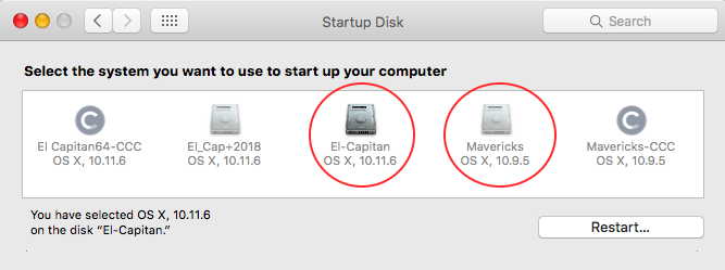

Exactly like my MacPro1,1 is set up, works like a charm.
Oh, the other Volume "El-Cap-2018" is the one with the patched 2018-001 security update, and yes it does work alright.
"Exactly like my MacPro1,1 is set up, works like a charm."
thanks, that's what I wanted to see. Must be cold up there.
