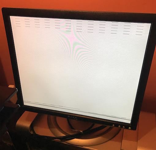

I inherited a Macpro2,1 without a hard drive. I installed one hard drive but I'm not able to boot from a bootable mac OS 10.7 DVD.
This is what I see while the DVD is loading, a stripped background behind the Apple logo:
After a while the Macpro gets stuck in this screen:
If I boot the mac without a DVD, a file symbol with a question mark appears, pretty much what I'd expect considering the fact that the hard drive is empty but the stripes in the background are weird.
For the record: I'm hable to hear the start up chime.
Any help on what can be failing? I've tried to run Apple Hardware Test but I can't get it to run.

It stucks when loading the drivers for it.
You can try safe boot by press and hold the shift key during cold boot.
Macschrauber
macrumors 68030
Dec 27, 2015
2,744
1,349
Germany
You should get a video card, or, if you have another mac you can install a system in firewire target mode. But I doubt it will run with your broken GT7300 ? You may bake the GPU to give it a few hours...
