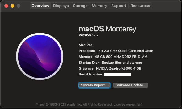

yes, thanks. well aware of OCLP as I got to HS with dosdudes patch.
Been keeping my eye out for a reasonably priced GPU that can carry the metal load on Monty.
