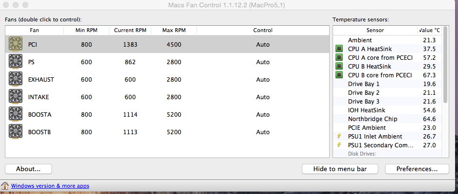

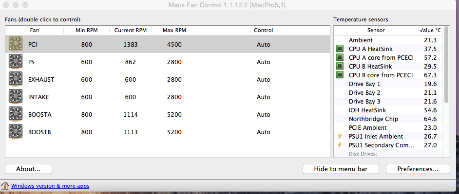

Can you provide some screenshots?
Idle

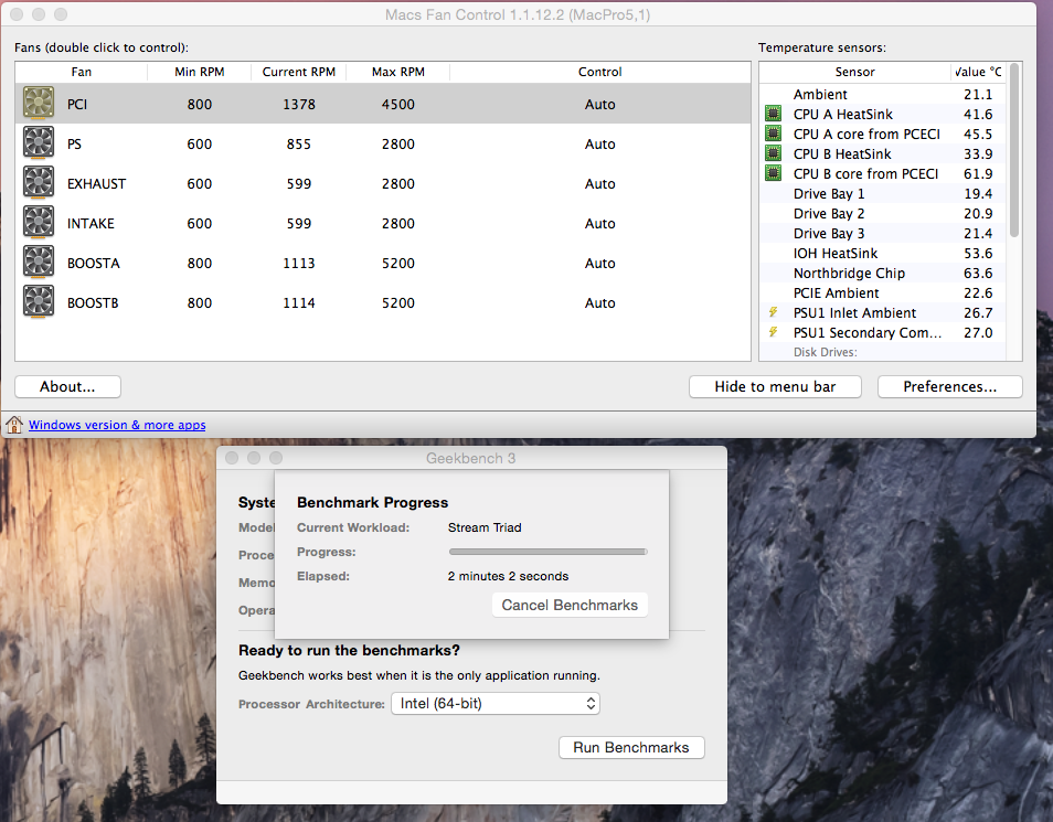

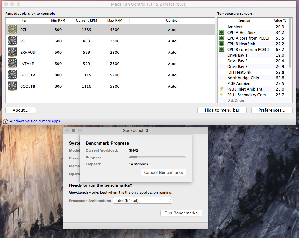

GB3 Started

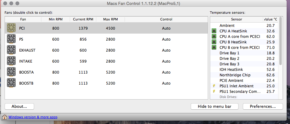

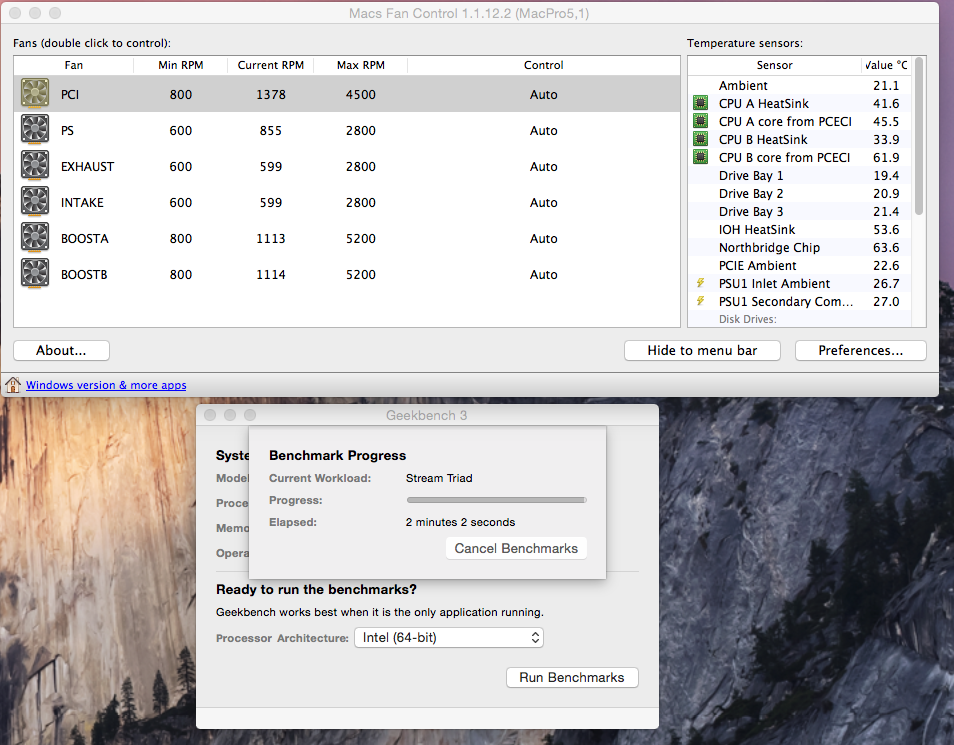

GB3

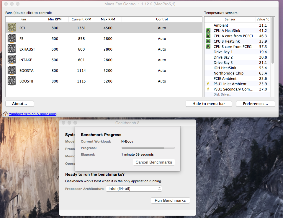

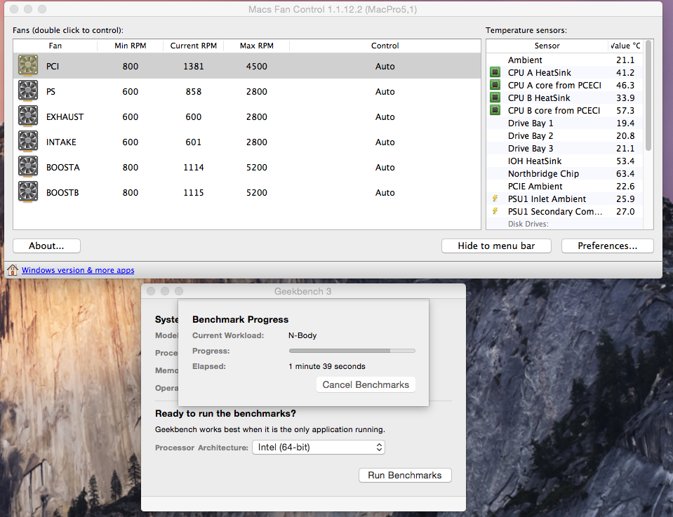

More GB3

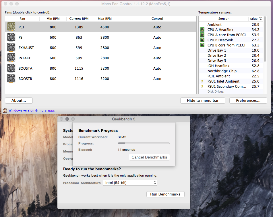

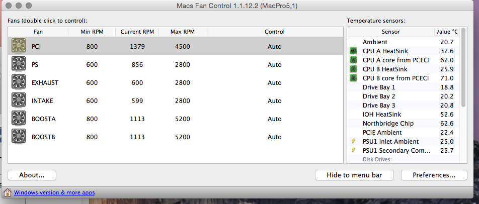

1 minute after completed

I see absolutely nothing wrong with your temps .. they actually look ideal ..I am quite jealous of your Northbridge temp (mine is at 76C).
It seems you are reading the temps wrong for your processors.
The temp CPU A core from PCECI (and respectively CPU B) is actually the difference between the core temp and the max allowed for the processor.
So the higher this number, the further you are from the max, the better.
This is why you see it decrease during a Geekbench test as the actual temps of the proc are rising and getting closer to their max. Does that make sense ?
Your temps are great 😉!

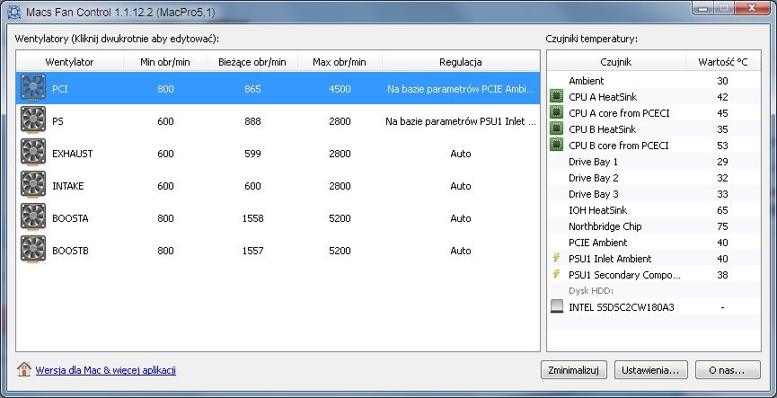

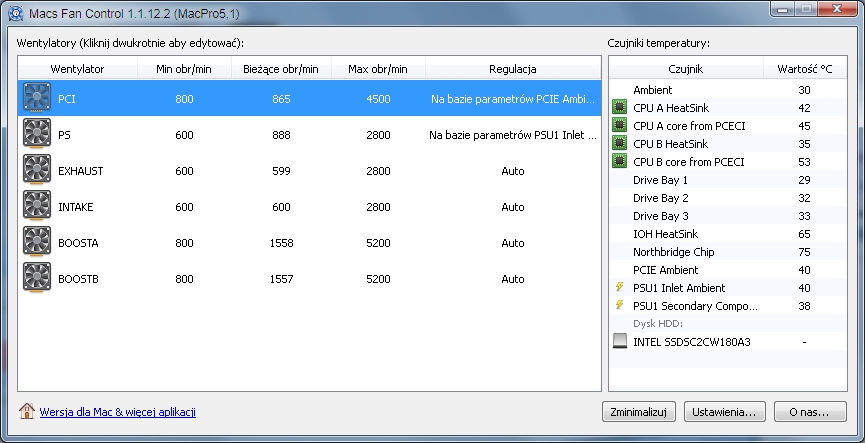

Please see my results from Mac Pro 4,1@5,1 with Apple branded 2x X5570's 2.9 GHz (top 2009 model) when idle. I'm using a bit lower speeds on PCI and PS fans because I'm using GTX680 which makes them noisy.
