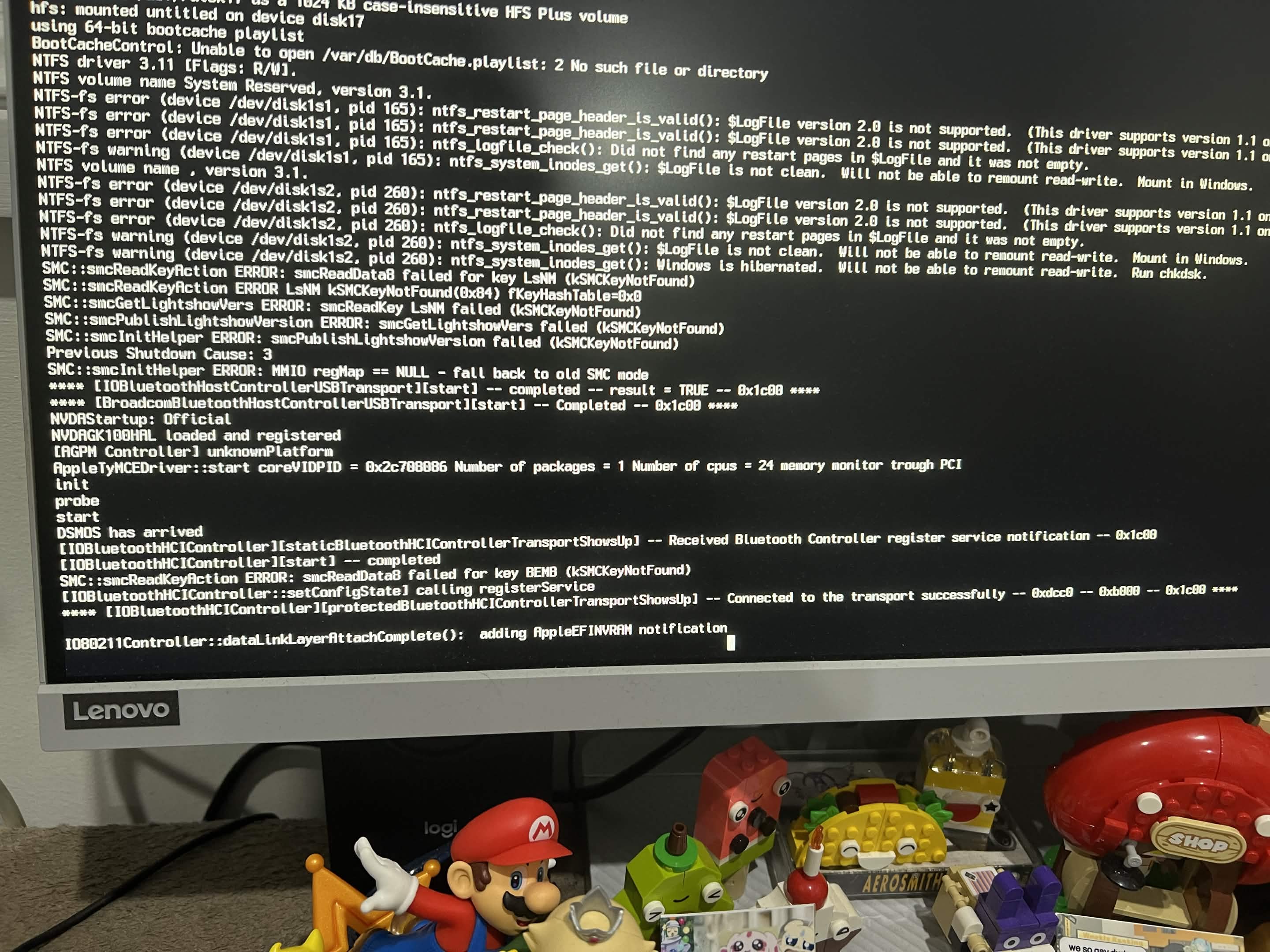

Anyways I tried verbose boot like, 3 times. Every time it either froze or restarted here…
Weird. You're actually very far in the boot process, past where I would generally expect things to get stuck.
It's probably a red herring, but you've presumably also noticed those NTFS messages. Is there any chance you can disconnect whatever NTFS disk you have?
