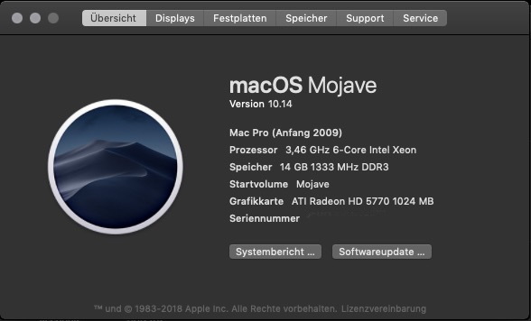

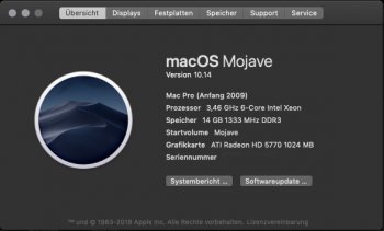

Successfully upgraded to firmware 139 with NVME Support injected (but not upgraded to mojave because of matching graphiccard). I plan to order soon a RX Vega 56 Red Dragon.
Mojave actual installed on a SATA SSD for testing.
