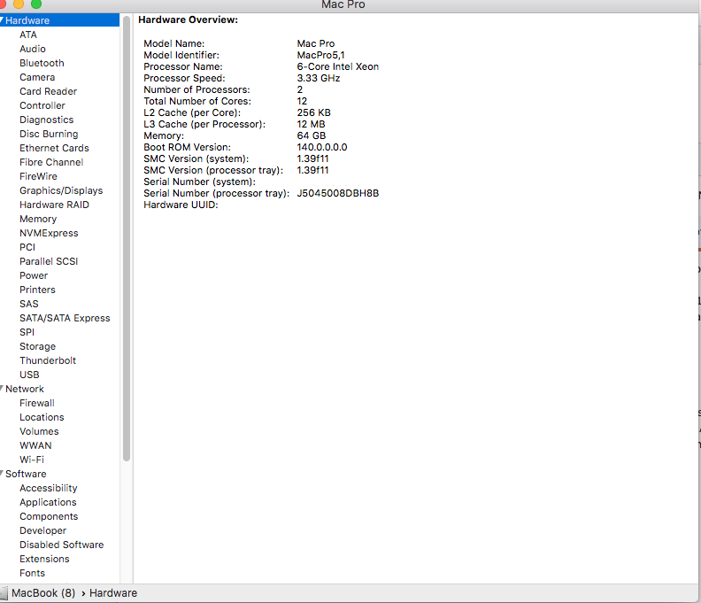

Boot ROM Version : 140.0.0.0.0
FYI: In Mac 10.12.6 the MSI Radeon RX 580 was exactly identified. In Sierra 10.14.1, it is exactly identified as "Radeon RX 580 8192 MB"

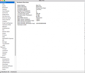

I have 5,1 12 core 2010-2012 mac pro with 64 GB Ram and Sapphire Nitro RX 580 (8GB) GPU. I installed Mojave on one of my drives that had High Sierra (10.13.6). Looks like Mojave installed but with the RX 580 I get a black screen but with the ATI Radeon 5770 its fine. What should I do? Clean install?

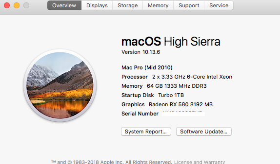

Woo Hoo x2
Thanks to macjunkie2013's recap on the procedures. Also big thanks to tsialex and h9826790's confirmation, I took the leap of faith doing the High Sierra and then Mojave upgrade with a Gigabyte RX 460 4G card with more or less the above procedure without much issues.
I did all CLEAN install for both HS and Mojave.
I manage to upgrade the firmware to MP51.0089.B00 then 140.0.0.0, without any black screen issues.
I have been quite happy with Sierra on the machine but going thru all these hassles preparing for the arrival of the NVME stick that I scored in the recent Black Friday deal.
Hope this help in case anyone is concerned with the Gigabyte RX 460 with Mojave.
