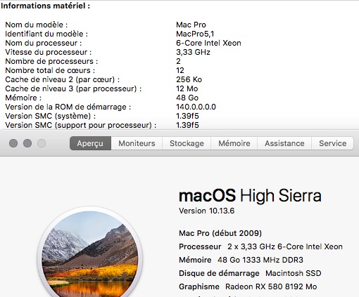

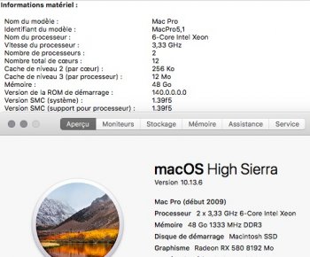

Hi after multiple try without HDD only usb mojave install key update was working well and now I'm still in HS but 140 boot rom :)

Your best bet is to simplify and use just one disk and GT120 to get MP51.0089.B00.
