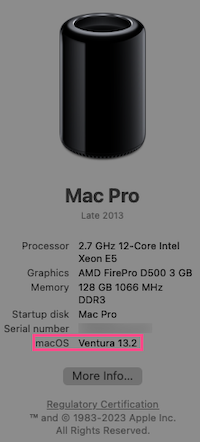

I just installed Ventura 13.2 on my MacPro 6,1. Everything works without problems. I only had a wifi problem but my eth works fine. No problems on installing.

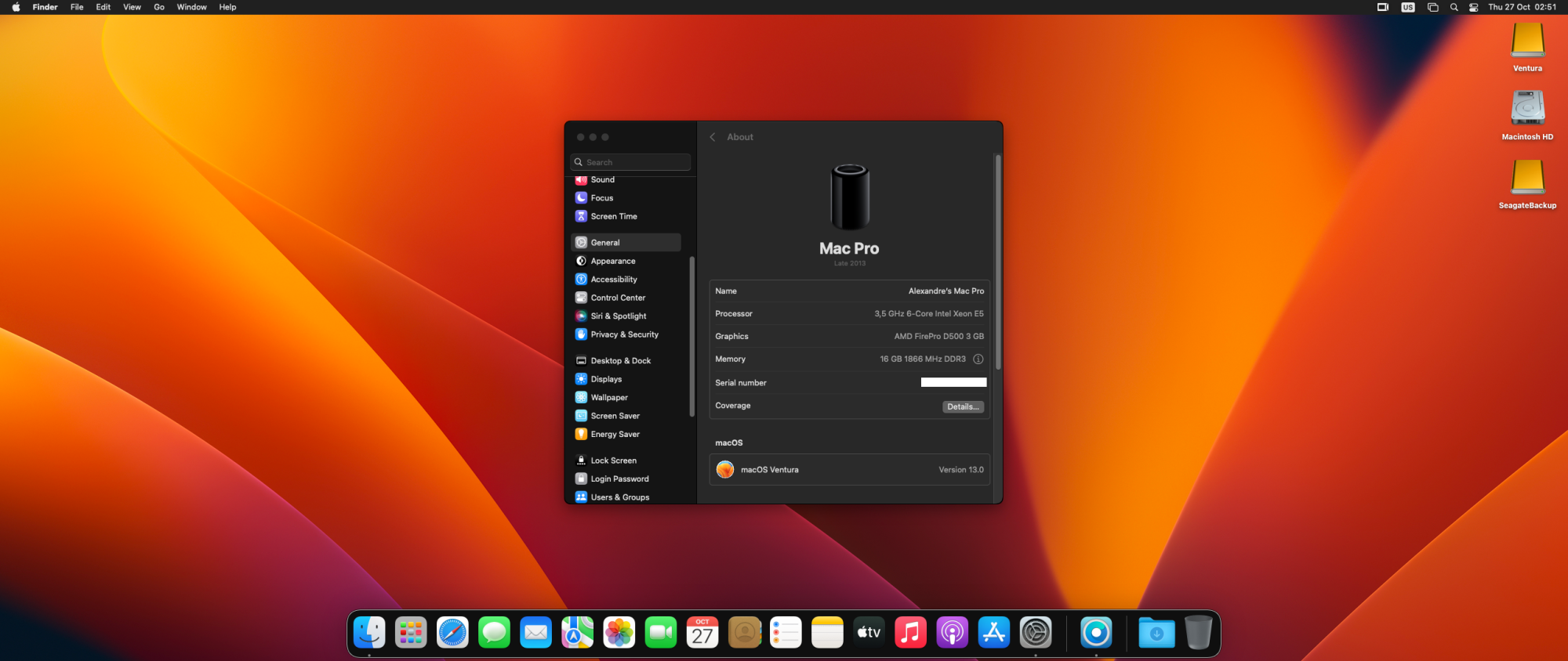

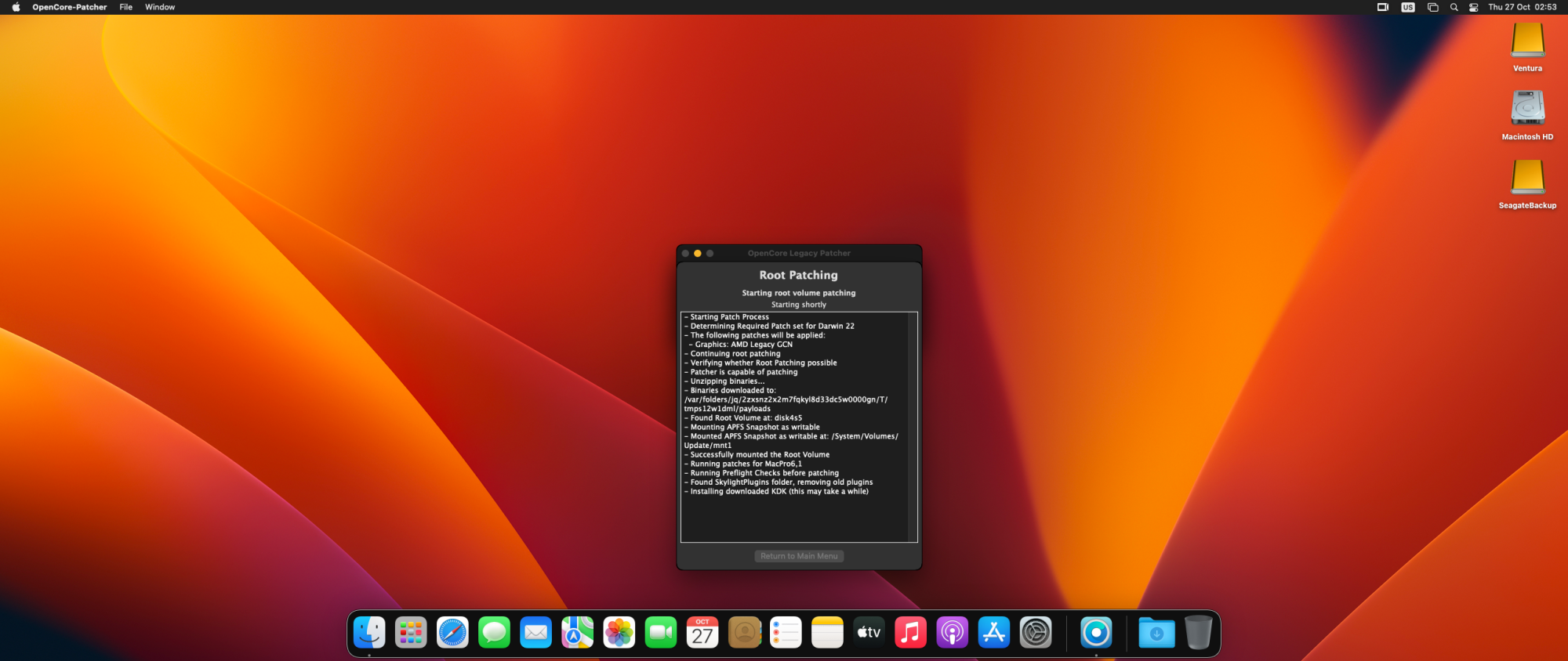

I make an update from Monterey use an external disk i install ventura on external disk and after i patched it. The macs works well without any problem. The update was perfect. Drm doesn’t involve any activity. So for the moment everything is ok. I will update here on usage.
Success!
Hmmm your Macpro has 128gb but Apple says only 64gb ram are supported. And alsways Apple says that the supported ram is ECC DDR3 1866 mhz ...
When you install a 32GB DIMM, the memory controller frequency is downgraded back to 1066MHz.
It's a compromise, you can double the RAM capacity of the late-2013 Mac Pro, up to 128GB of RAM support when four 32GB DIMMs are installed, but at lower frequency.
For a lot of people, more RAM even with lower frequency still gives more performance = job completed with less time.

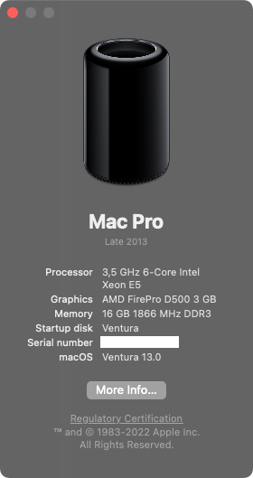

Tonight, OCLP team (thx @khronokernel) started supporting MacPro6,1 and Ventura for the first time:
OCLP 0.5.1 Nightly brought Ventura support for the late-2013 Mac Pro. Somethings don't yet work, like DRM and CPU power management (Ventura is running with the VMM flag enabled), but besides that, it's fast/stable and the installation is fully automatic:
DRM is one of the two major bummers right now and nothing (really nothing) that demands DRM with Safari works, Netflix asks for Silverlight for example:
The other major bummer is the missing macOS CPU power management - no Intel SpeedStep, so the CPU is always clocked from the nominal to the Turbo frequency with no SpeedStep down clock when the CPU is idle - this generation of Xeon processors can down clock to 1,1GHz when idle.
Sleep works, fan works - the SMC works and is independent of the CPU power management by macOS, so the fan works as expected. While you are not in CPU load, no greater heat is generated, even without SpeedStep working at this moment.
Apple removed AppleIntelCPUPowerManagement.kext from Ventura, and OCLP devs are waiting for Apple to publish the XNU sources to start re-implementing it (edit 20221103: Apple already released the XNU sources xnu-8792.41.9 for Ventura GM) - the workaround to begin supporting the late-2013 was setting the VMM flag and running Ventura as a VM.
