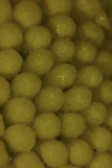

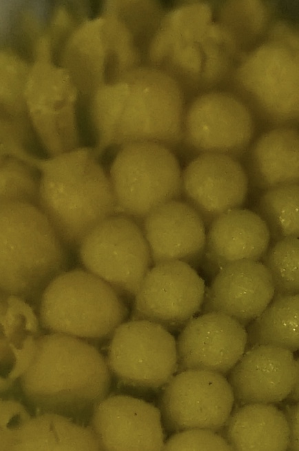

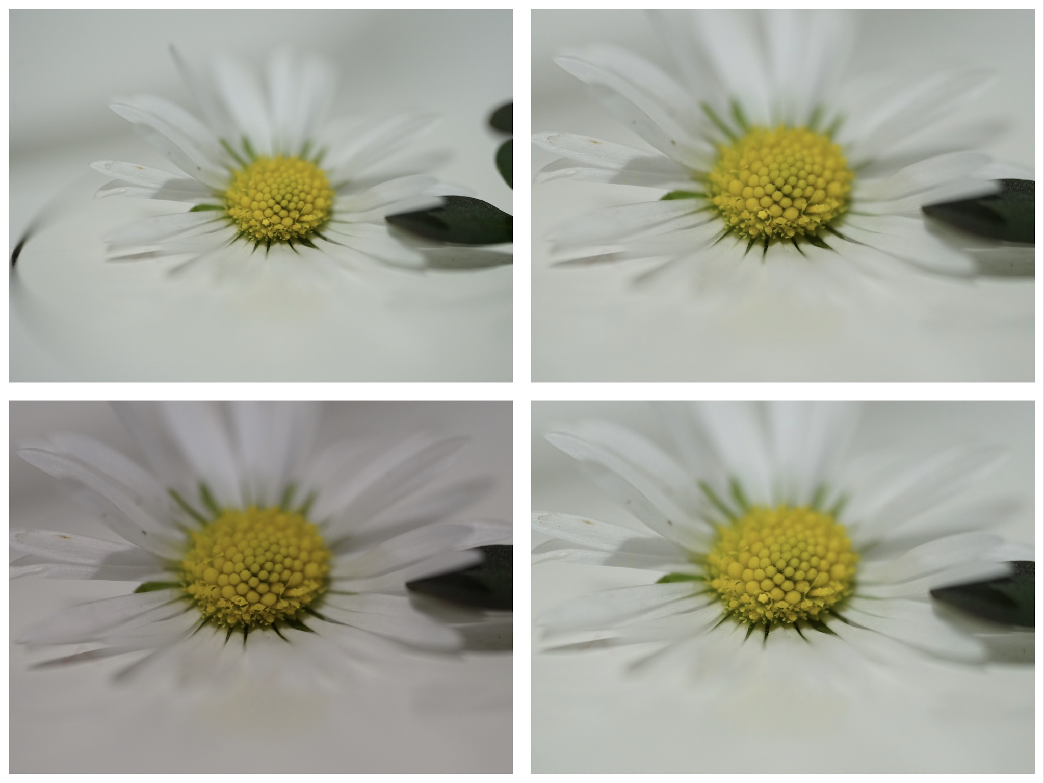

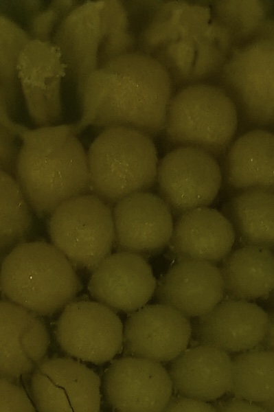

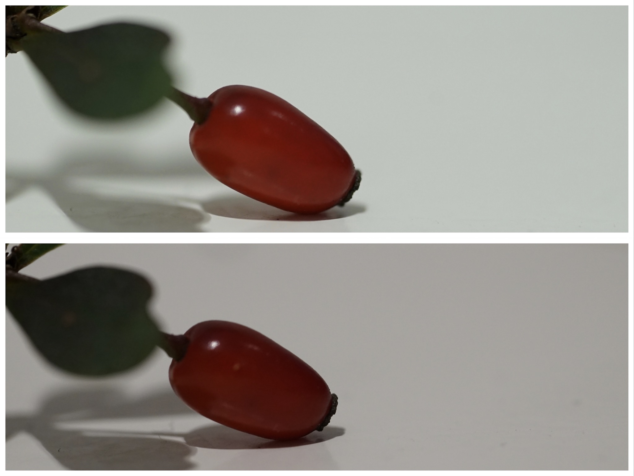

[doublepost=1508276168][/doublepost]I tried to take pictures (and cropped some to the max) of a 1,5cm flower (indoors and did not had a lot of time) - Thanks to my local shop for allowing me to test the equipment (My lens is in service for cleaning).
To tell the truth I do not see so much differences...Seems good in a case where FF images are manually cropped a lot more for my test purposes (maybe some differences, but it is also very hard to tell - I held the cameras in hands, indoors, angles were probably a bit different).
In any case IBIS and fast AF, HAF made it so much easier for taking macro images...
Crop, APS-C, f/5.0
Crop, FF, f/5.0
Crop, APS-C, f/5.0
First is FF cropped, second - APS-C (manually cropped as well)
[doublepost=1508276514][/doublepost]9E46D789-05FB-4AD4-92E0-AB9E3B9974C9.jpeg
Resized. Darker one is APS-C, first one is uncropped FF, others - Cropped FF to match the flower size.
