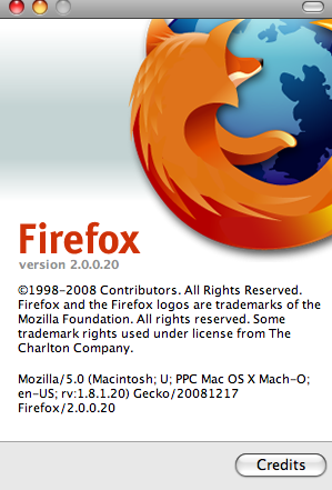

Second test from 10.5.8 and Firefox 2.0.0.20 with upload attachment.

Must be something local on your computer. As you can see above I made two test posts from an iMac G5 using 10.5.8 and Safari 5.0.6 as well as Firefox 2.0.0.20 while adding attachments.
I didn't experience any crashes of either browser or the OS.
