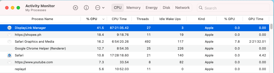

I've been using a setup like that for the past year with my MBA M1 clamshell'd. Lenovo Thinkpad Hybrid Dock (Display link version) and two 1080p monitors.
I do web dev / stuff and occasional video editing - it works for my purposes perfectly.
However I don't know if I would want to be running 4k monitors. Even at 1080p displaylink will use ALOT of CPU when there is alot of motion on both screens, for example if you run a YouTube video on both monitors it will eat up to 50% of the CPU!
Normal use case though, viewing web pages etc ... generally around 5-10%
