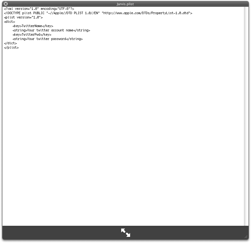

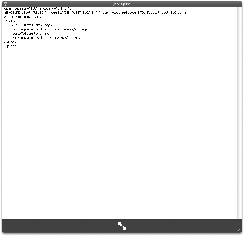

I got a copy of the library script from the site, but now my task is, what do i put for the smaller files that the library depends on? i.e. "property jarvisname : (do shell script "defaults read /Library/Preferences/Jarvis TwitterName")" etc that it looks upon.

Seems like the script depends on a preferences file(a file that ends with plist).
Is there a file in /Library/Preferences/ called Jarvis.plist?
Try something like this :
Code:
defaults write /Library/Preferences/Jarvis TwitterName "Your twitter account name"
defaults write /Library/Preferences/Jarvis TwitterPwd "Your twitter password"
You'll get a file looking like the attached tumbnail.
More info on the defaults command here : http://developer.apple.com/library/mac/#documentation/Darwin/Reference/ManPages/man1/defaults.1.html
Link : https://discussions.apple.com/thread/4016480?start=0&tstart=0
