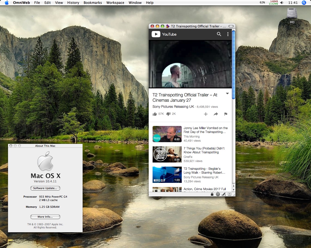

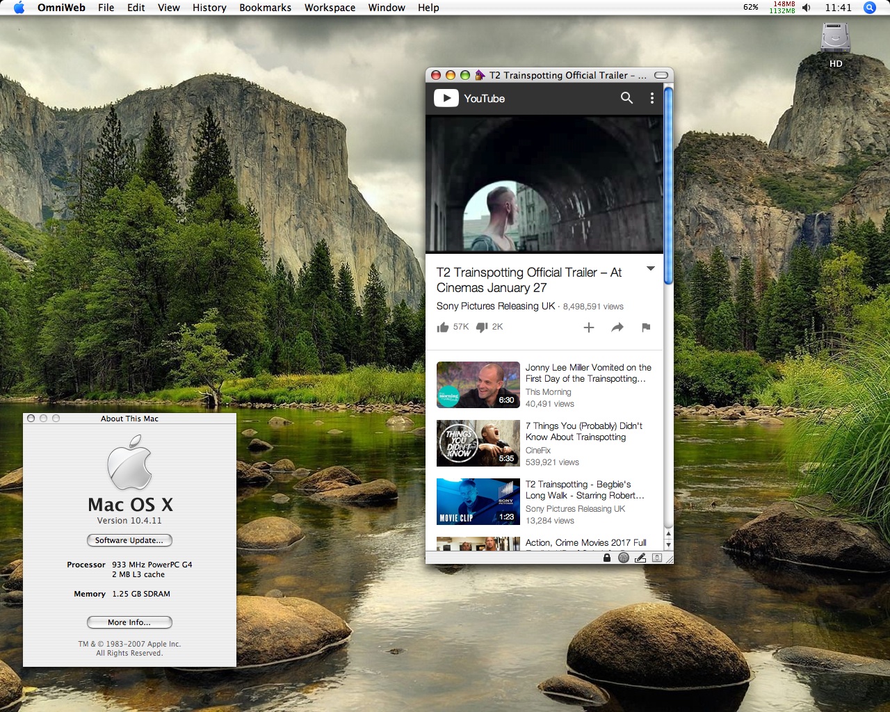

For ease of use, after testing Safari/Webkit, I've found the optimal solution to be Omniweb 5.11.2 using a mobile device user agent - with this you can browse quickly around Youtube from a mobile device perspective (with few or no ads) and click and play for instant playback.
The mobile device user agent I use is:
Mozilla/5.0 (compatible; MSIE 10.0; Windows Phone 8.0; Trident/6.0; IEMobile/10.0; ARM; Touch)
As you can see from the screen shot, playback uses between 60-70% CPU on my 933 Mhz Quicksilver.

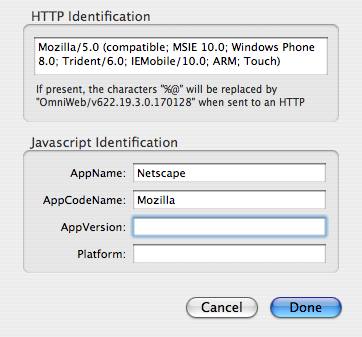

How do you setup like the one you have with the mobile device user agent?
Firstly, you must be at the mobile Youtube page not the desktop one:
https://m.youtube.com/
Initially, it might throw you back to the normal page but you can change it back after setting the site preferences.

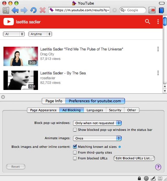

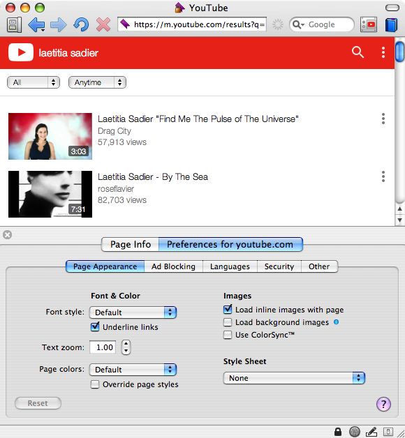

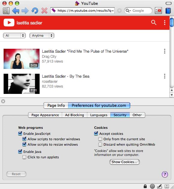

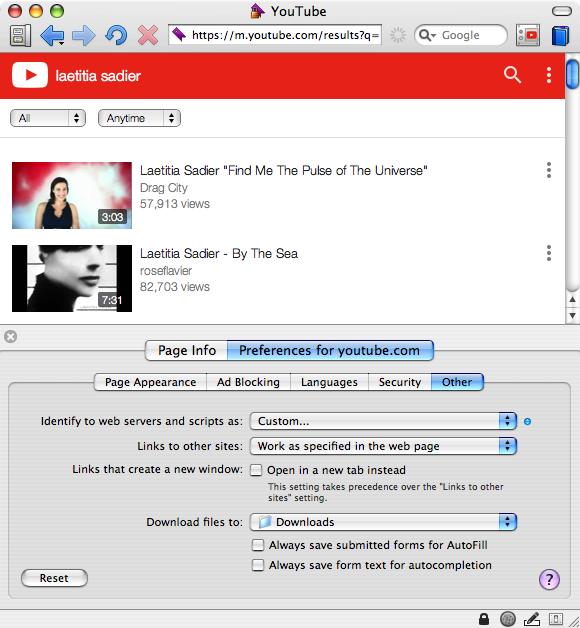

From the menu click Omniweb/Show Site Preferences then enter the details as below:
You can then make sure https://m.youtube.com/ is back in the address bar and all should work.

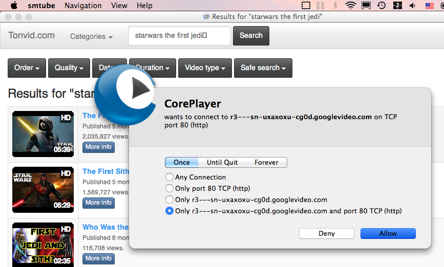

Got it working with Smtube , been struggling for the past 2 hours but I did it.

First I downloaded the source of smplayer here :
http://smplayer.sourceforge.net/en/downloads
Went into the /src directory , and typed make , about a half hour later on battery (PB G4 12" 1.5Ghz) compilation was completed.
I copied the smplayer.app from the /src directory to /Applications.
Then downloaded the source for smtube from here :
http://www.smtube.org/en/index
In it's root folder did make, about 15 minutes later compilation completed and in /src I found smtube.app which I copied to /Applications.

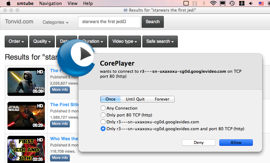

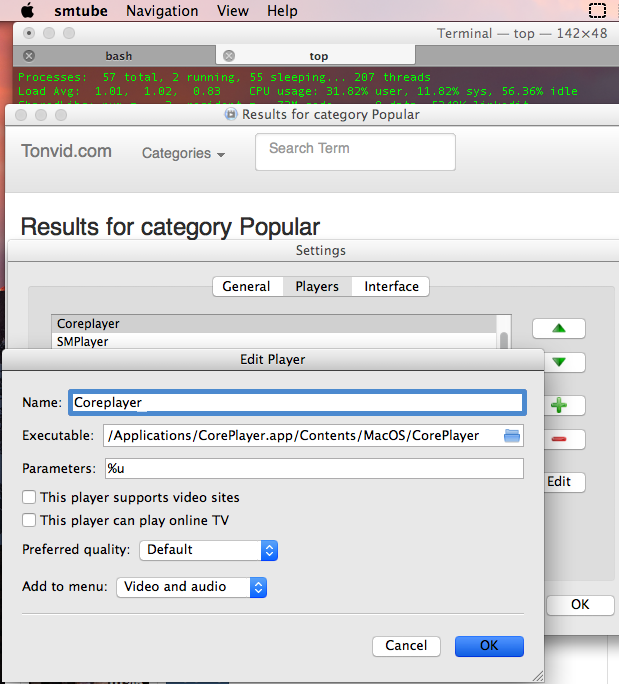

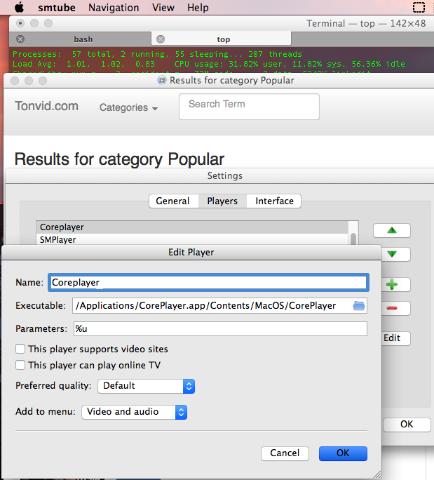

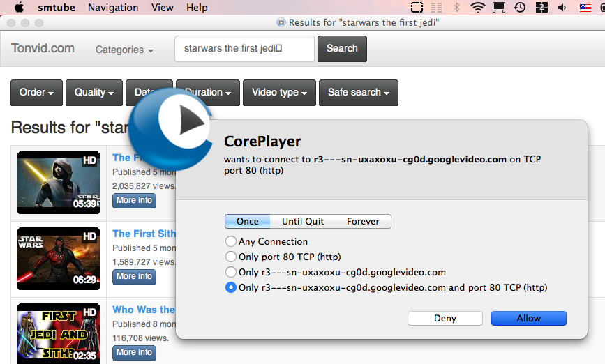

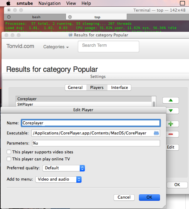

I tried to get this working with the Macports mplayer but then realized hmm why not Coreplayer 🙂
Open smtube , Preferences, Players , + sign to add a player , make sure that "This player supports video sites" is UNCHECKED. Otherwise it will feed the youtube.com?=watch type URL which none of the players understand.
And tadaah, smtube feeds the stream to Coreplayer , 720p
After doing a clean restore , I'm going to install only smtube and Coreplayer to see if it works, I think you can do this without mplayer,smplayer but just need Qt4 for the GUI
