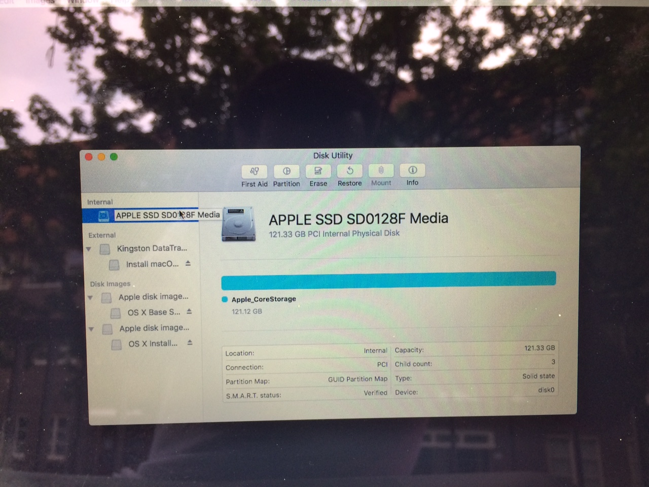

I don't know for sure I was running sierra, may be a version of Yosemite. With the sierra usb installed I can see when I enter Disk Utility on the left side of the window: APPLE DDS ect. ect. ect. When I click on that drive I see my drive and there is a complete filled blue bar ( i include a picture). In the top of that window I also see a restore button. Hope to be 100% what to do, but really need some info on it.
Any help will be highly appreciated 🙂 ,

There's NO partition visible in Disk Utility for your internal drive.
Do you use File Vault?
You should be able to unlock the drive, by choosing Unlock in the File menu - while you are in Disk Utility.
If THAT unlock doesn't work (because you don't use File Vault at all, or there's no unlock command in the File menu when you have that drive selected), then something has happened to your drive. ( I think the Sierra boot drive is just an unhappy coincidence)
tnx
It appears that the hard drive is not partitioned. You should see a logical volume under the physical volume. See this as an example of what you should see for core storage in Disk Utility: https://blog.macsales.com/38191-roc...sierra-disk-utility-to-partition-erase-drives
