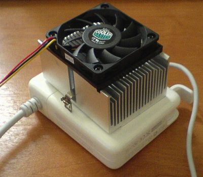

What? Apple PSU's get unfeasibly hot? You don't say...
I should patent this 😛
I think you should be able to sell that design to Dell🙂 . I think it blends in their model line up.
