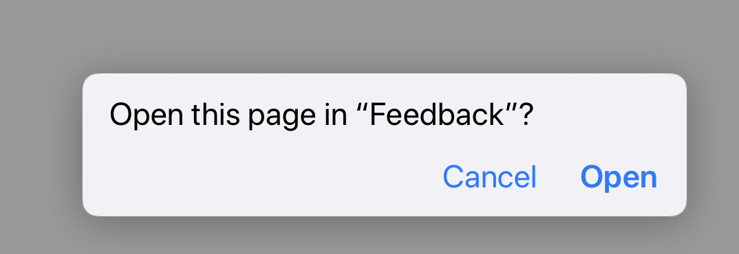

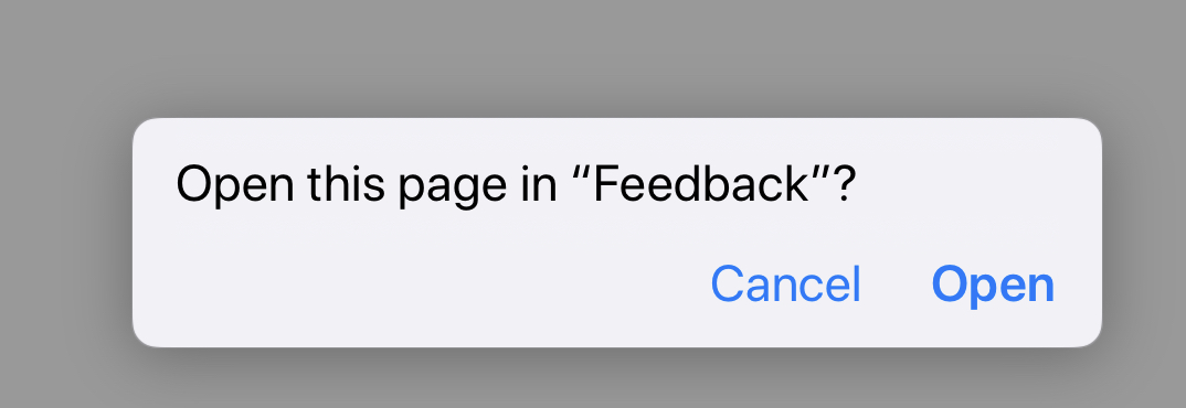

If you use that link it opens the feedback app that beta testers have front and center when they install a beta profile. It’s always on the software but not visible unless you have the beta profile or use that browser link. The good thing about it is that it will collect relevant files and upload them to Apple after you detail the problem, so they may see something obvious in those files.
Tonight I had the problem with the backlight keys not coming on again. I tried to sign in to that link you gave me. I kept putting in my Apple ID and password but could not get any further than that...I was stuck in a loop. Everytime I hit enter it just brought up the sign in page again. Is there an app I need to download?
I have been a beta tester and maybe it’s because of that I can enter that to submit a report. Have you ever registered or installed one of the public betas? You wouldn’t have to have a beta currently installed, I don’t at this time, but if you had registered for it this might function for you. Or it could be a temporary issue with their servers. I assume when you enter the link this image appears -
Right afater posting my reply above I realized that the backlighting on my keyboard was not turning off. So I used that link and submitted a report. Again it’s possible that it may only work for those that have been registered in the beta programs.
Yes, I got that. It was after I put in my Apple ID etc that it would not accept it and kept bringing up the same page as if I entered wrong ID or Password.
