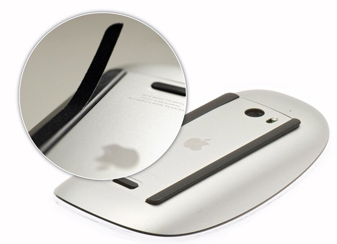

The only way to fix it is to get a new mouse, or replace the strips. Something like this (random internet search):

Replace the glide strips with new ones. Maybe some company markets replaces; for sure Apple does not sell replacements on their store.
If you are crafty, you might be able to fashion your own from some PTFE (recognized more commonly by its trade name: Teflon). You could switch to white material instead of black. Teflon's natural color is actually white. It's dyed black for things like non-stick frying pans to hide unsightly discoloration but Teflon pipe tape is the natural color.
My Mountain Makala 67 mouse has white PTFE pads (and came with a set of replacement pads).
Since the Magic Mouse glide pads are straight it would be a fairly simple project. You'll have to research on your own on which adhesives work with PTFE but this is an ideal use for an Internet search engine.

Definitely not buildup. I will replace the tracks with Teflon strips I already have. doesn’t look like a difficult project.
