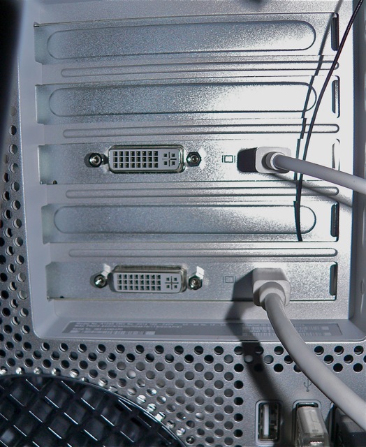

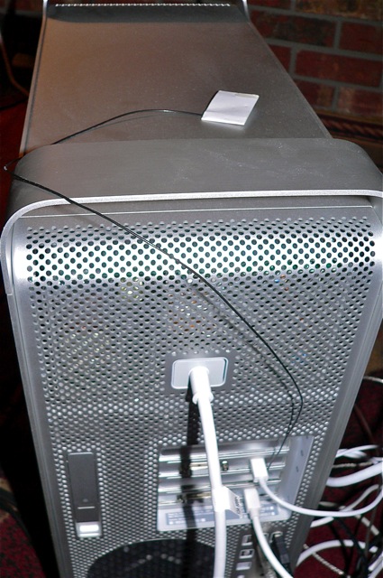

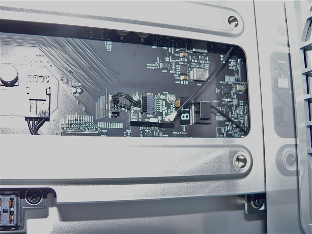

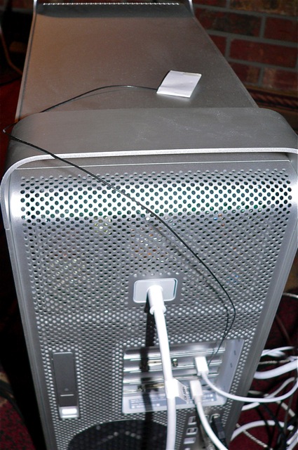

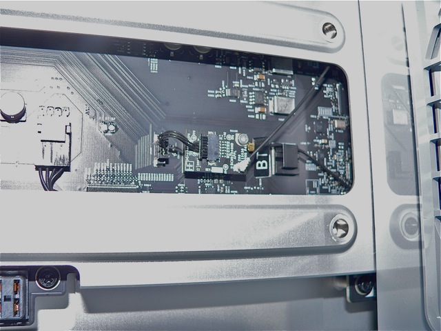

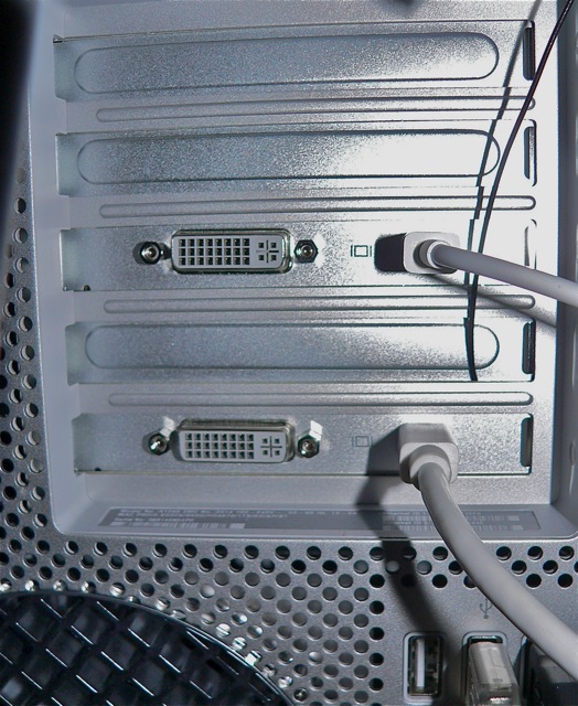

Here's some pics of the antenna installed. The stock bluetooth antenna wire is visible in the first photo as it's labelled. Unfortunately, the connector on the replacement antenna is just too big to fit through the cheese grater holes on the rear of the chassis so I had to have it exit through a PCI slot cover as shown. The antenna wire is long enough to reach the top of your work surface and the antenna itself is protected by a piece of cardboard which makes it easy to tape to anything close by. While it's crude, and I wish Apple would have provided a better solution, this is better than being forced to use a wired mouse.
