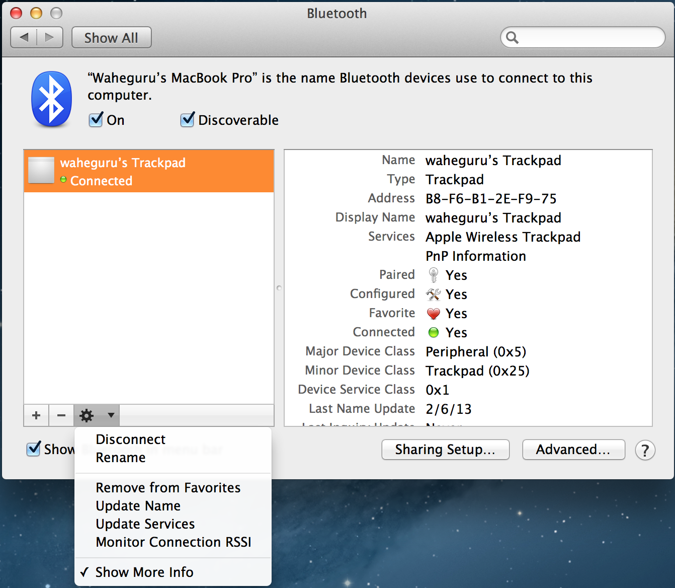

I'm not sure how much of a difference it will make, but under the settings menu, which is just to the right of the add/remove buttons on the Bluetooth menu, you can add the mouse to your favorites list, as well as update service. Doing so shouldn't hurt anything and can only help matters.

From the drop down menu, Add to favorites.

It is in my Favorites already and still drops in and out
