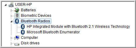

I already tried a full update of everything. The PC my office supplied is a new HP ProBook 4520. It has all the stock Windows 7 and drivers installed.
Regardless I tried a manual update for everything listed under Bluetooth in the Device Manager. Still same issues.

I don't have any way to cross check as this is the only Bluetooth mouse I own.
I have tried to initiate a driver update via the HP tools but nothing is available.
