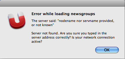

I keep getting this message and all of my log in info is correct.

It looks like it's a bug in the current version. The message that I get above sometimes comes on and then it sometimes doesn't. I usually have to launch and quit Unison several times before it latches onto my server.
