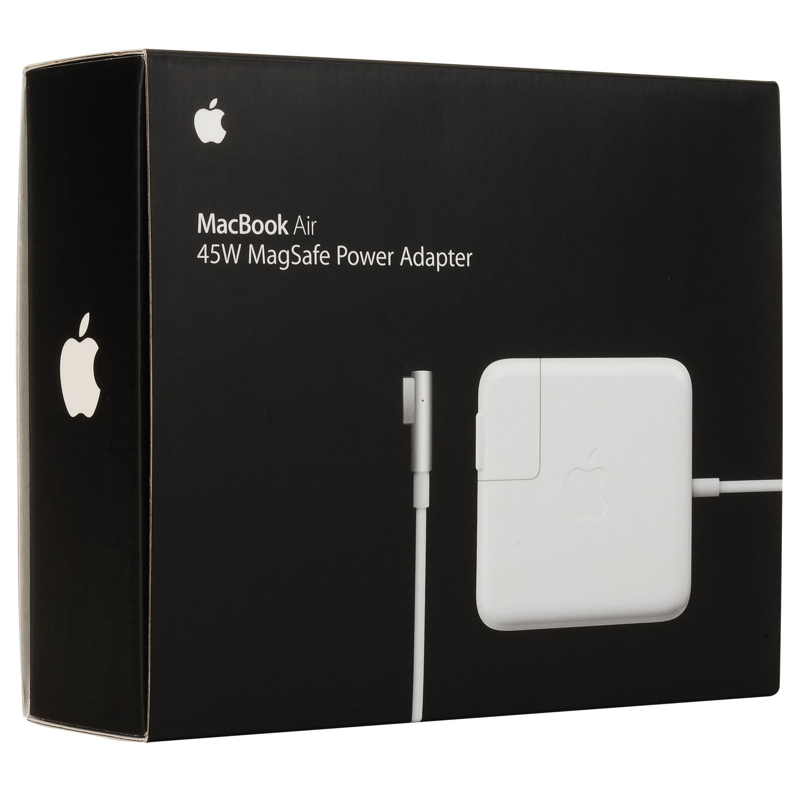

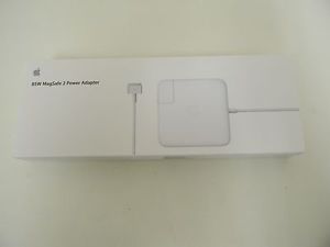

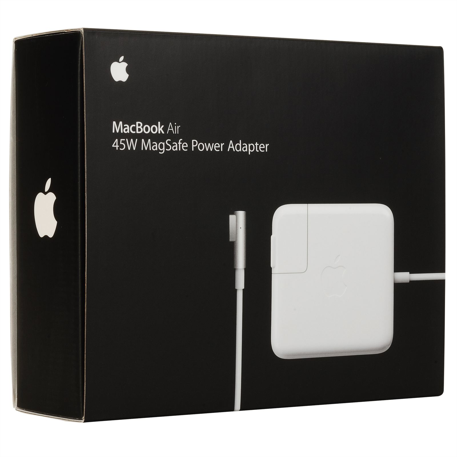

Can you post pictures of the charger? Did it come in a box similar to one of these?
Apple does not license the MagSafe design to third party manufacturers. What this means is that if your chargers are not actual Apple products then they are likely using a MagSafe connection that has been connected to a possibly (probably) substandard charger.

It came in a plain brown cardboard box. Although to be fair, so was every other product in the shop.
On the receipt it says magsafe 2 85w, and on a small label it says AC and some numbers... then a couple asian characters. Does that mean it is not genuine, how do I find that out?
Here i was thinking I was smart paying only $40 and not $100 :/

If it was that much less, I'd be very suspicious. You know the old saying, "If it sounds too good to be true..."
