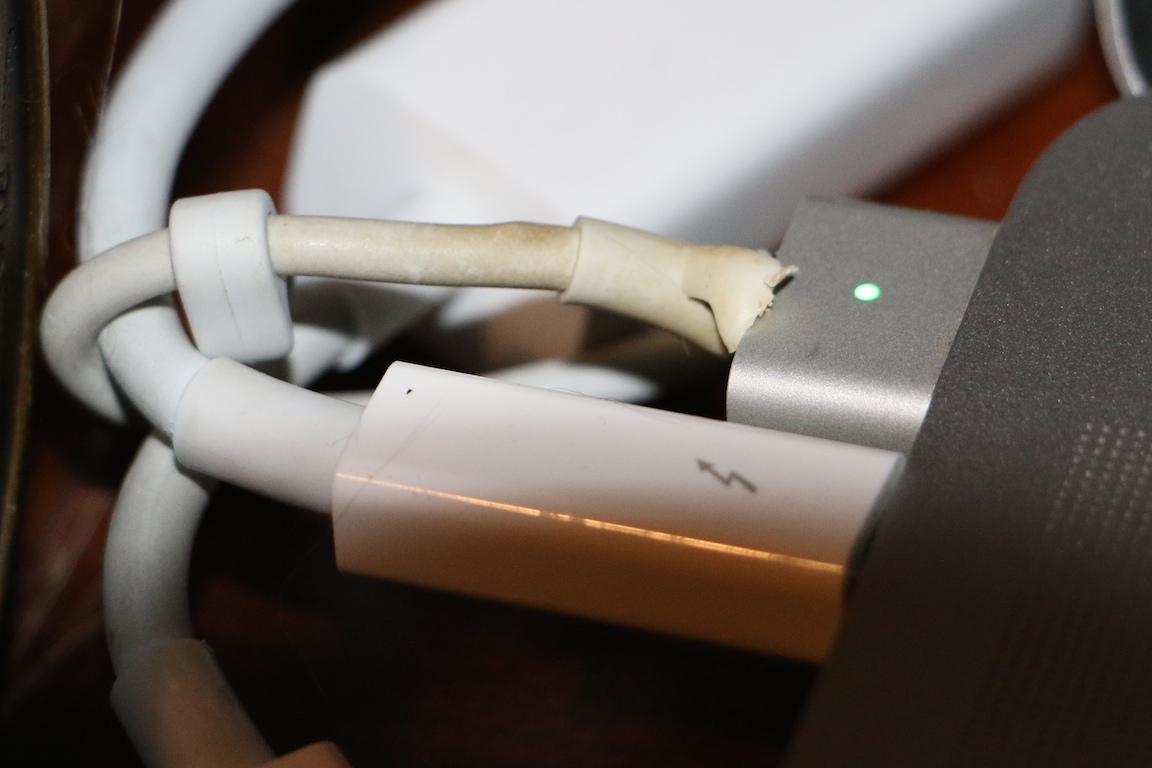

This is what the old one looked like after 8 months of use, the geniuses say this is cosmetic.
