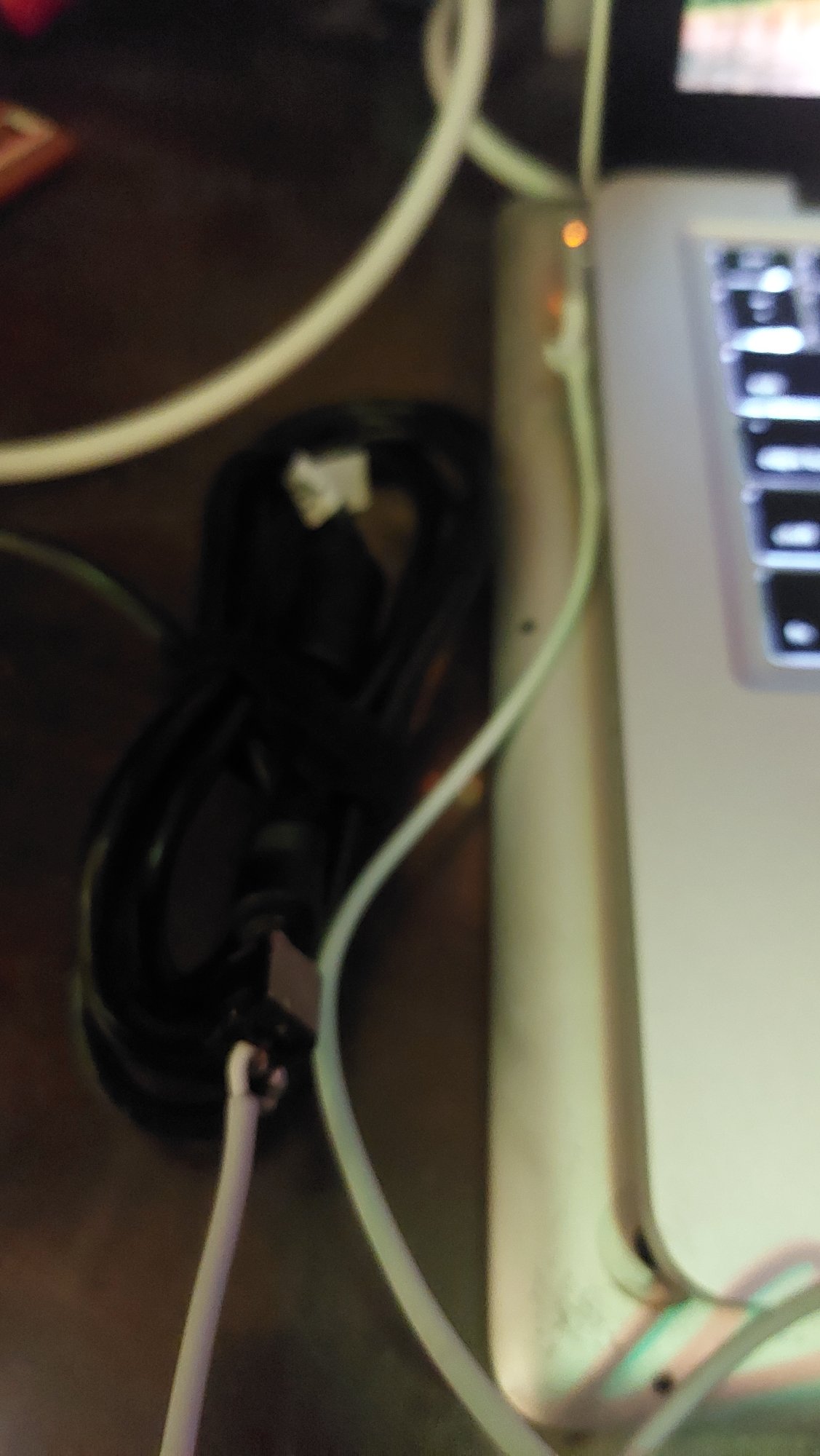

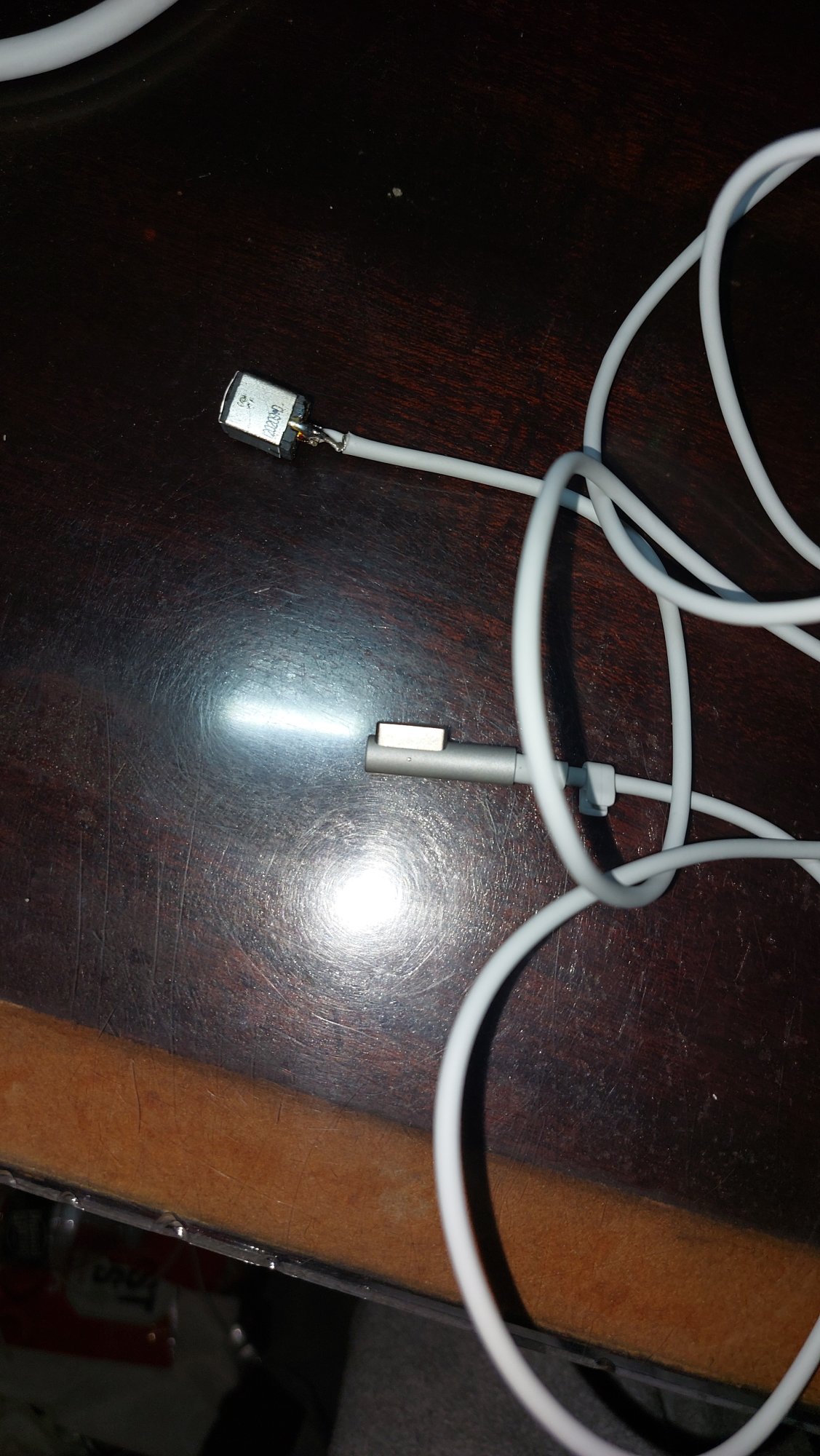

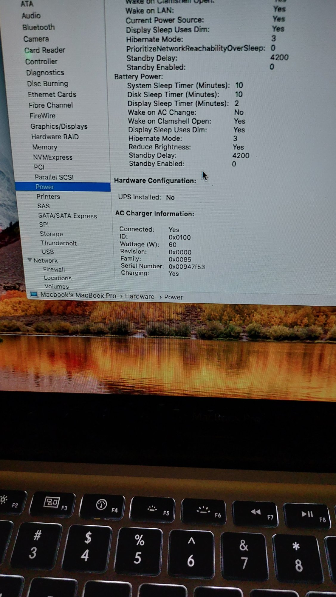

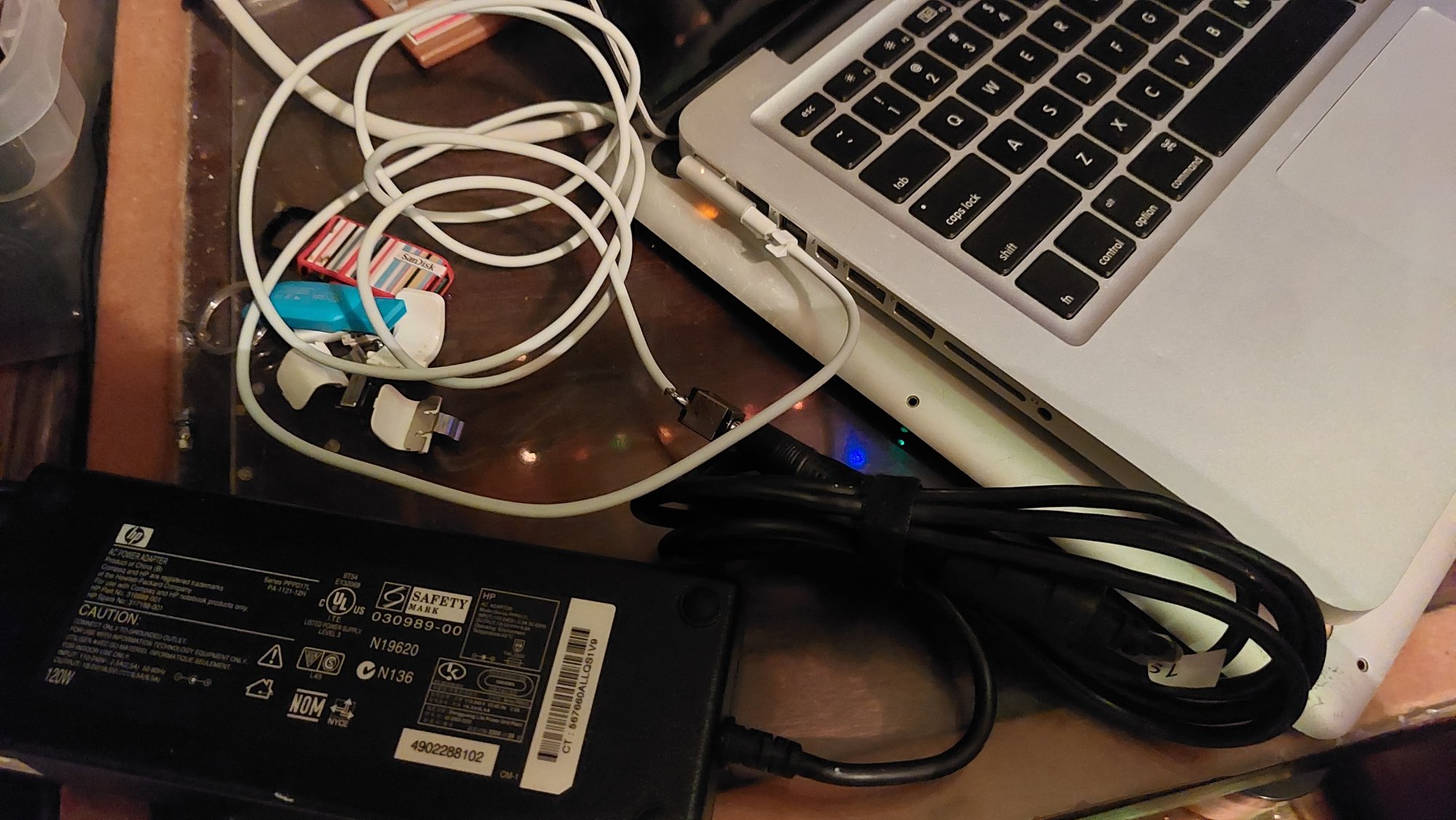

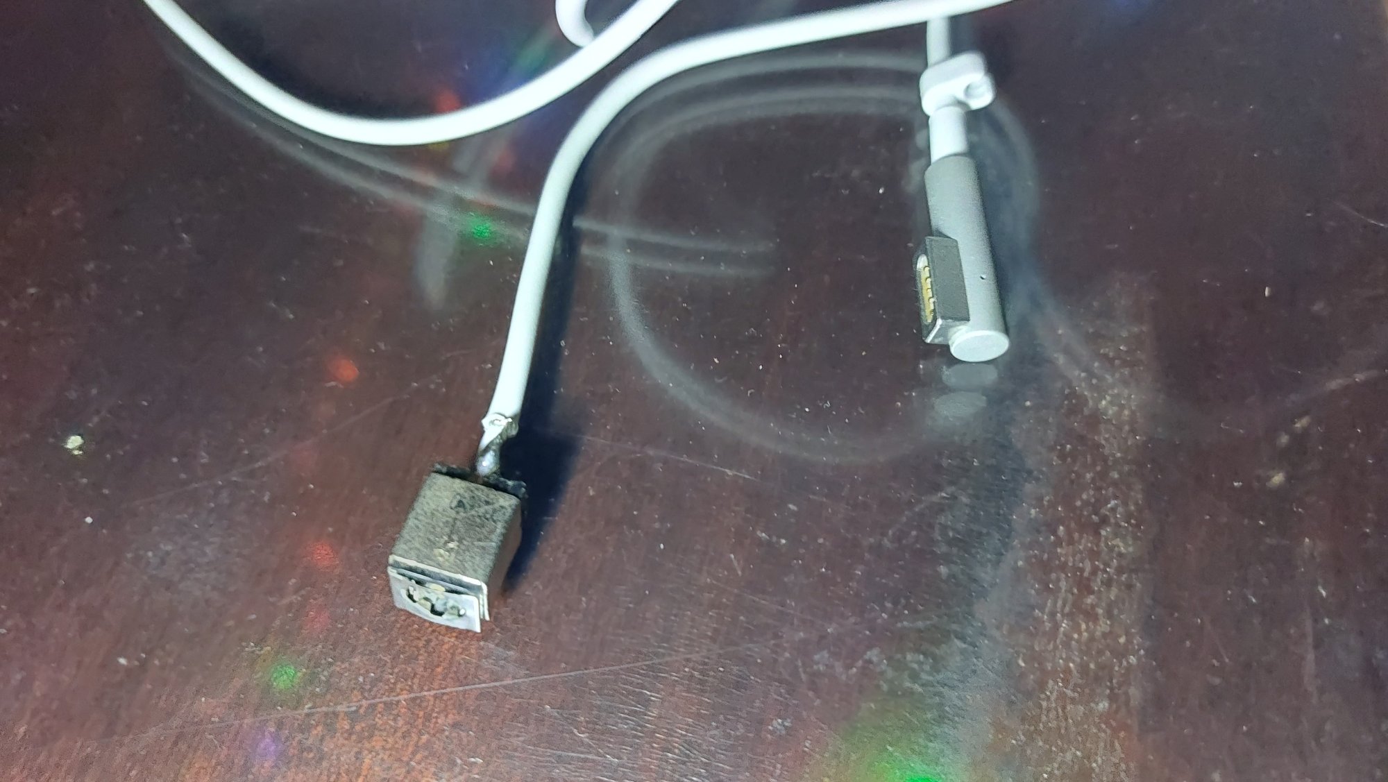

My friend gave me an early 2011 MacBook pro 13 inch. The power adapter he included was a terrifying piece of aftermarket junk that wouldn't even charge the battery all the way. The only other magsafe adapter I had is also aftermarket and makes strange noises under load. I cut the cord off of one of the aftermarket chargers and measured the voltage coming out of it at a constant 19v DC. There are only 2 wires in the cord and it appears that all of the circuitry necessary to negotiate magsafe is in the magsafe plug itself. So I decided to see if you could just solder a barrel jack onto the other end of the magsafe cord and use it with a regular 18.5v PC charging brick. It works on both my 2009 polycarbonate MacBook and the 2011 MacBook pro. If you have a broken apple charger or a shady aftermarket one this could be a very cheap or free way to get a working charger. You just need a broken magsafe charger, a barrel jack, and a high quality PC laptop charger with a barrel plug.
Yep, there’s a simple ID chip in the plug that advertises how much power that cable can deliver; the MacBook will talk to that plug and then perform some power handshaking to activate an official Apple MagSafe charger, as detailed on Ken Shirrif’s wonderful site:
Bypassing that handshake, like you have done, makes the cable a little bit more dangerous in that you could get a minor shock if you lick the exposed end, but beyond that, it’ll work just the same.
All the power regulation happens in the MacBook, and I think that it should work with input voltages as low as 12V.

Interesting. I didn't know they bothered doing that. I guess it makes sense with the pins exposed like that on the magsafe plug.
One benefit to my barrel jack adapter is you can use a larger power brick that will run much cooler than the apple one. I'm using a 120w brick with a 60w magsafe end so the computer will never ask for more than about 60w. The brick doesn't even get warm.
