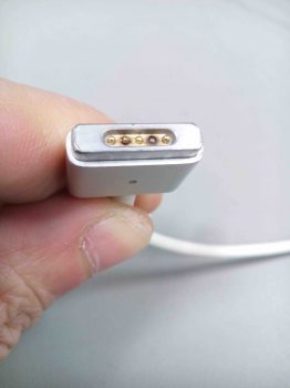

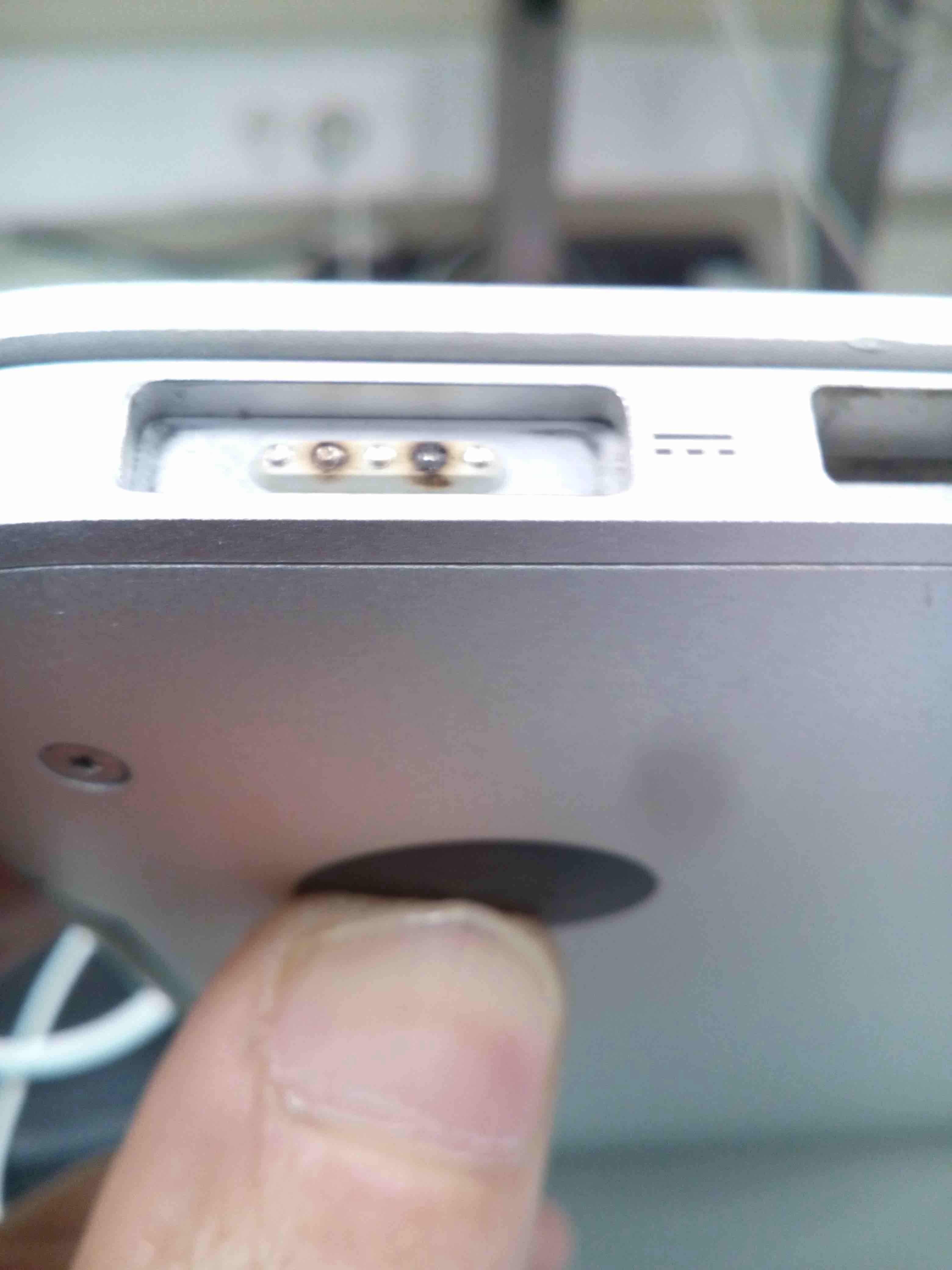

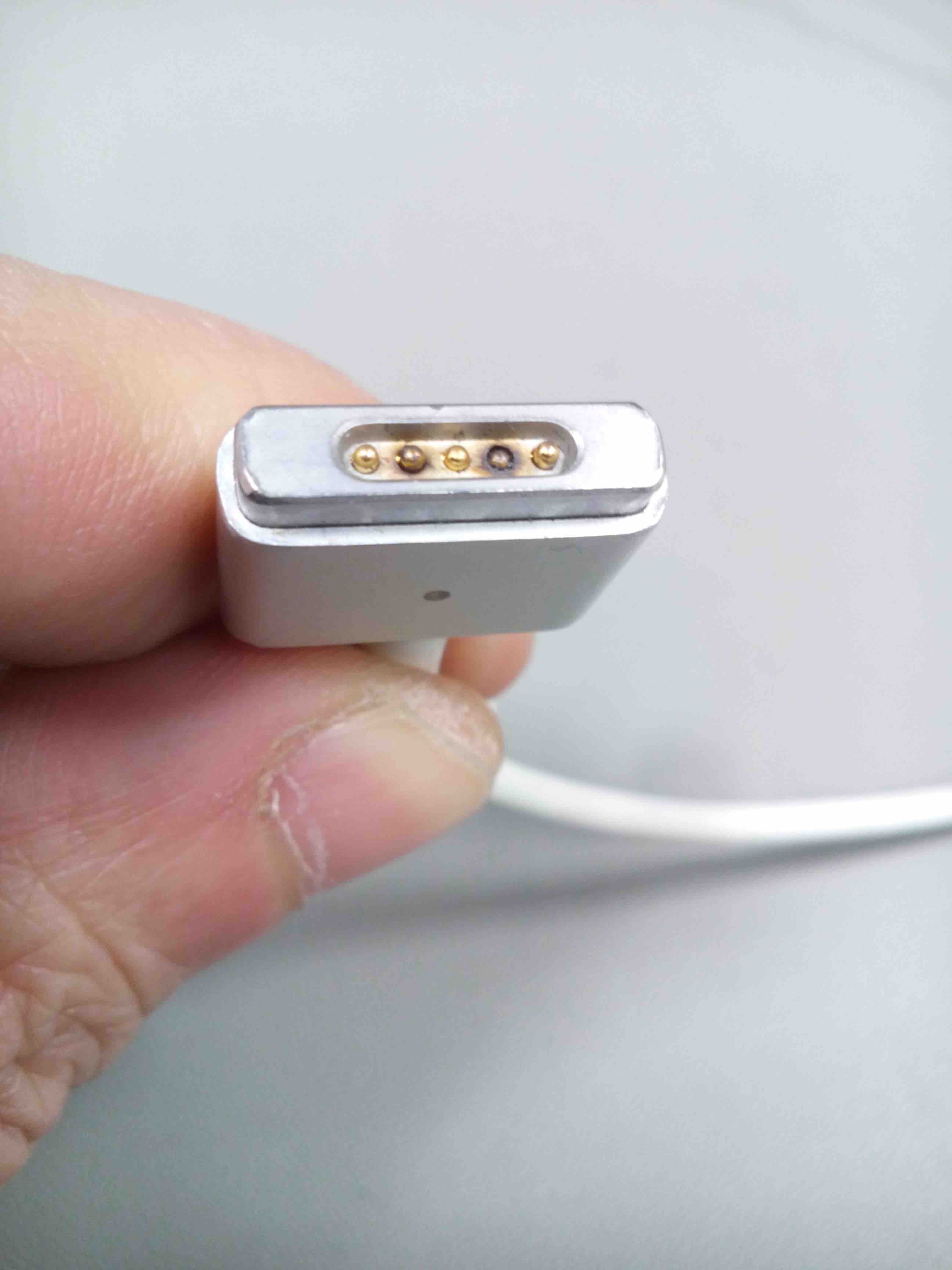

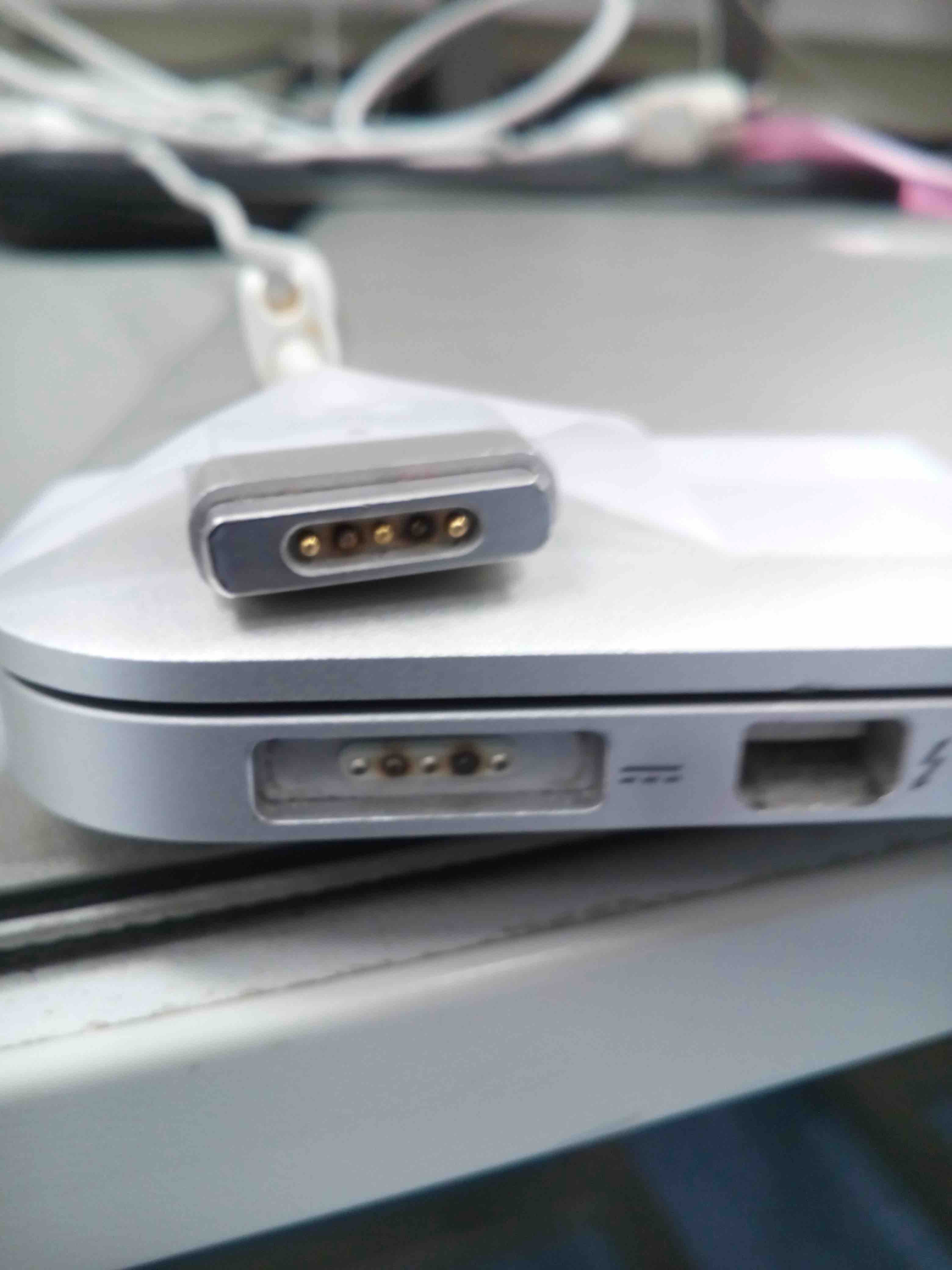

Hi, I am facing an issue with my MacBook Pro. As I mentioned in the title,two pins in the MagSafe adapter cable are burnt and as a result the charging is unstable and the cable becomes extremely hot at the very end,I guess it's like a power leak. Moreover the two same sockets seem burnt in the port of the MacBook.Still I don't know if the adapter left a mark or they are also burnt there. Possibly the first,since I tried a different cable and it worked flawlessly.

i had this same issue on one of mine... just cleaned it really well with toothbrush, contact cleaner spray and wd40, did not happen again (2+ years)
it does happend due to crud in the contacts, no matter how well you think you take care of things 🙂
edit: yours seem to have gone too far tough - might need to replace that plug if the pin does not move back out after cleaning.

at least clean the port man. leaving it like that is asking for the problem to reoccur.
Of course.
My question was if that marks are just marks and nothin more. I guess since another adapter works perfectly,there are only that and I shouldn't worry.

Can't tell that sort of thing from a picture. To be safe, you should replace the DC-in board. They're really cheap, and really easy to replace.
I would go with the technician that said they'd replace the DC-in as well. Just because a new adapter "works perfectly", that doesn't mean that the other adapter was the root cause of the problem.
Most common cause of stuff like that happening is lint. Lint can have metallic particles in it. Just one example: "dust" from lead pencil shavings mixed in with other lint. Such things are really attractive to MagSafe ports (pun intended.) Backpacks are a good example of a place that can accumulate such things over the course of several years. That's why I always try to remember to put my MacBook Pro in a backpack with the MagSafe port side close to the top of the bag (there is a method to my madness.)

@frank33v thank you for your support. I have a question for you. The local technician said it's better to also change the mag port,because he doesn't want to take the risk (not that he found a problem). Apple engineers said that they don't feel it's necessary unless the technician found a problem. The thing is if I follow the technician advice, I can't get refund for this also. I tried a different adapter myself and it worked flawlessly,so I think the MagSafe port is ok and the marks in the photos were caused by the adapter. Do you think it will be risk not to change it? You changed yours because it stopped working or because you saw marks like that?
I changed the mag port because it had become very intermittent. Apple had already given me a number of power bricks and I didn't think they would give me another. Since replacing it my last power brick is still going strong...much longer than the past two. Although I do have black/burn marks on one of the pins again on the DC-in mag port....such a bad design.
