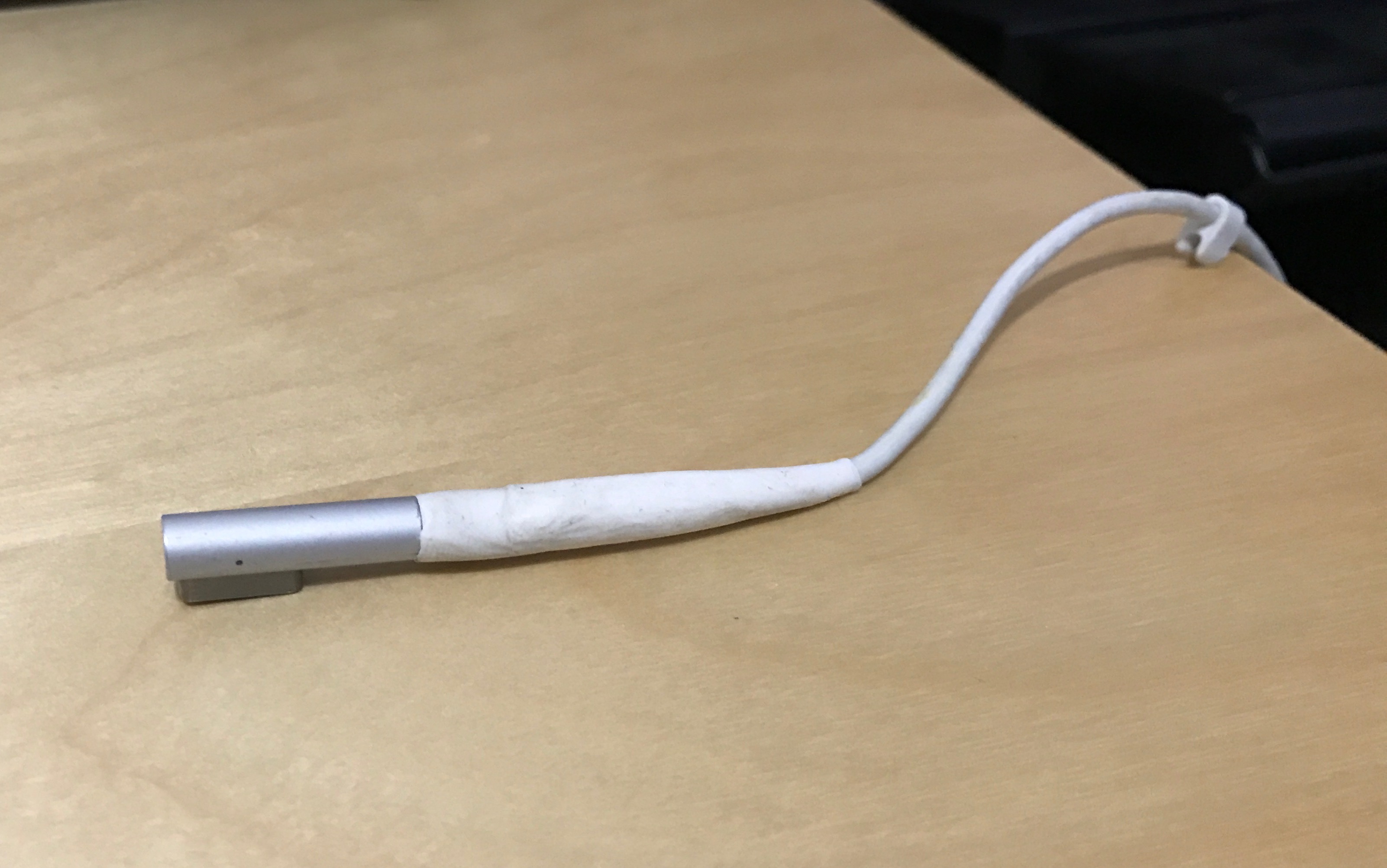

A sachet of Sugru shouldn't cost more than a couple of $s (although you might need to buy more than you need, I found lots of other uses for the stuff and it lasts well past the recommended 'use by date'), can be pretty neat, and probably more resilient than the original cable. I've taken a picture of one of mine, which has been used for 2-3 years.

sugru will fix all your cable fray issue.
I sugrued my cable around 1.5 inches around the fray. Now it's fraying at the start and end of the sugrued area, haha. I'm debating what to do about it. Maybe I made it too thick. I don't know gauge, but I'd say it's roughly twice as thick as the rest of the cable with the sugru. Maybe that made it too rigid.
