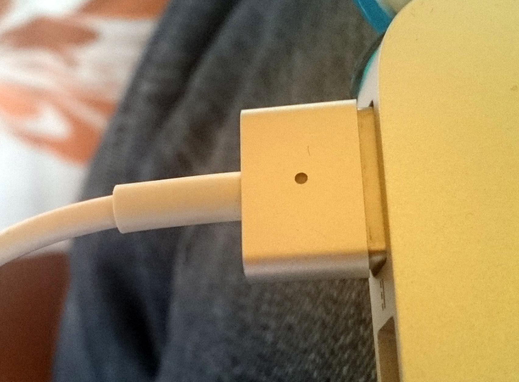

Hi all,
I bought an Air a month ago and in the last 10 days or so it looks like MagSafe started disconnecting way easier than before. Specifically when I press it down it immediately falls out or just disconnects while staying in. I am not 100% sure but it does feel like it didn't do that two weeks ago. Would you say it's normal and it's supposed to have such weak connection?

This is the problem. It's "half-connected", as in the cable is in the port... but it's bent just enough to actually disconnect.

Some kind of ferrous/magnetic debris is probably stuck to the magnet inside the connector on the MacBook Air.
I've seen this a few times now (metal shavings, broken staples), and, depending on WHAT's stuck in there it can be difficult to remove.
You are correct I'm afraid. There's something dark/dusty in the corners there. No clue how to remove that :/ (also no clue how it even got there)
I'd suggest using sometime plastic and relatively soft (so as to avoid scratching the inner surface) to try to flick/pick it out.
I certainly don't believe it's something you could claim under warranty (nor am I suggesting you think it is), but maybe your local Apple Store Genius might have a trick they can do for FREE.
Apple suggests a cotton swab (cotton bud) or a soft bristle tooth brush.
See point "8" in the article below:
https://support.apple.com/en-us/HT203207
I don't have any issues with my magsafe connector it fits in snuggly and only disconnects if I apply a reasonable amount force. However I just discovered some dark debris in there. I've been able to clean it all out with a cotton bud with a cleaning wipe attached to it.
Yesss. I cleaned up the dirt/dust/whatever it was with a folded piece of paper and problem is gone. I still wonder how come this even happened, but I'm glad it was possible to solve.
