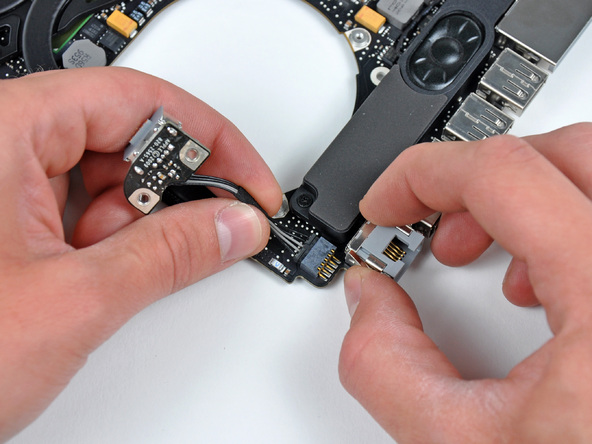

My Macbook Pro (unibody, late 2011) slipped and fell on the ground. Now there's a bad connection with the power adapter. I've tried different adapters and the problem stays, so I guess it lies on the Macbook jack.
Since there's a slight bump on the casing, I'm suspecting Apple won't cover the repair. I have some technical experience fixing computers, so I'm thinking about giving this a try. My guess is it's only a matter of fixing the small DC board properly.

Is the MagSafe board lined up properly? It might have just gone slightly out of alignment.
You'll need to take out the logic board to replace it, but you can try to realign it easily, just loosen the two screws that hold the MagSafe board down, and use a MagSafe adapter to align it whilst loose.

It appears to be lined up. My guess is the connection from the small dc board to the logic board might have loosened a bit with the bump. I fear that continuous usage might screw it up unless I fasten it.
My only concern is completely voiding the warranty, though...
