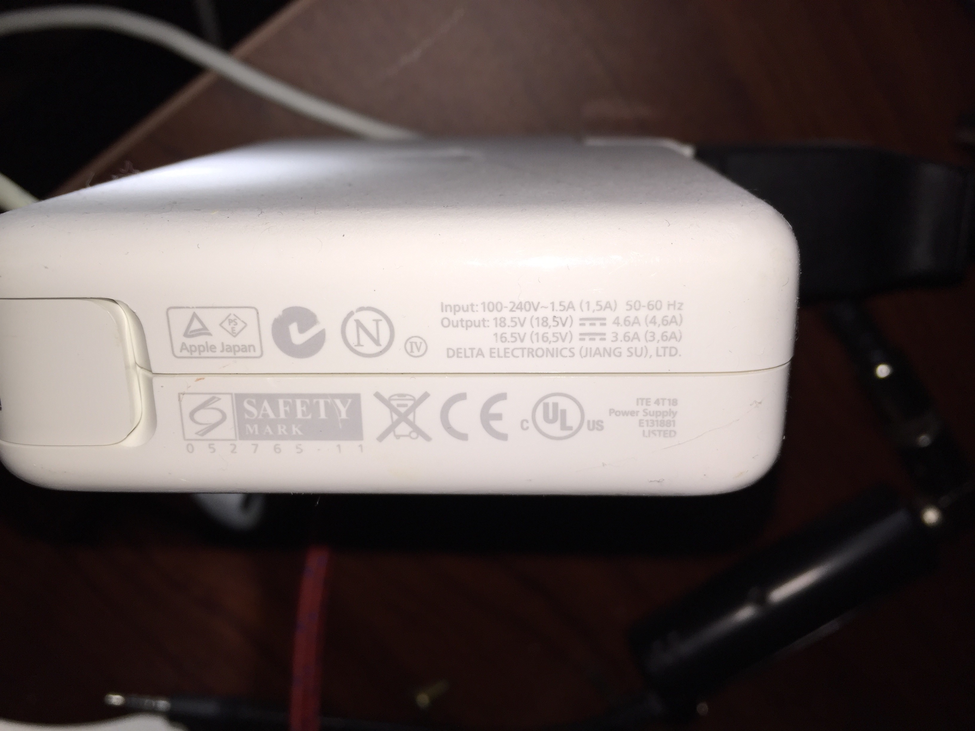

I have a 2008 Macbook Pro (15") that I've got about 2 additional power adapters for situated at various locations. I JUST bought a brand new 15" Retina Macbook Pro and would like to reuse the power adapters on it.
Is this possible?
Physically the magsafe plug won't fit but isn't there an adapter out there?
What's the wattage restrictions on this?

Cool. So basically as long as the wattage is the same it should be fine, right? (after magsafe adapter, of course)

Is this an 85w adapter?
