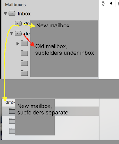

I'm using IMAP and want to see subfolders of Mailboxes under them. The default folders are setup in Mailbox Behaviours to be under INBOX/Junk/Drafts/etc. The problem is new subfolders are moved under a separate section. Mail was restarted multiple times and I tried creating the subfolders on the server and in Mail and it's the same.
This was working in the past but I haven't done it in Sierra before.
Old mailbox: I created subfolders and they were added under the account's Inbox.
New mailbox: Subfolders are added under a separate section.
Any ideas on how to get the custom subfolders to be displayed under the mailbox Inbox?

Thanks for the reply. None of the above are local folders (I've created them on IMAP webmail). The IMAP provider and setup is the same for both Mailboxes, new and old. What I don't get is why they're showing differently.
For anyone looking for the same solution: you have to go under Advanced IMAP settings and remove IMAP path prefix. All folders are then shown under Inbox.

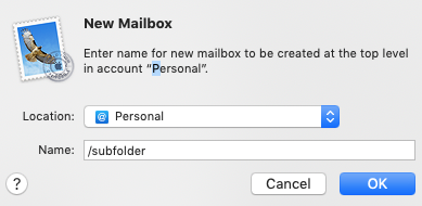

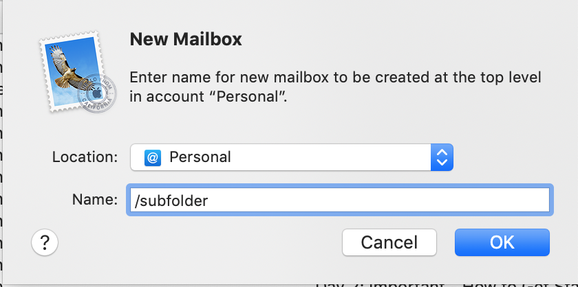

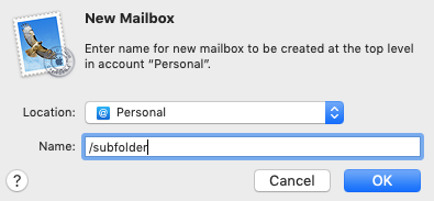

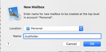

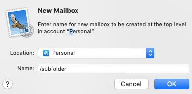

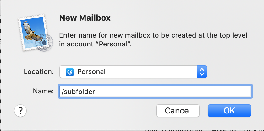

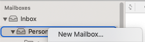

I found out today how to do this so I hope this benefits someone.
OS X 10.14.4
Mac Mail Version 12.4 (3445.104.8)
1) Right click on your "Inbox" -> "New Mailbox"
2) In the "Name" field type a forward slash + name of your subfolder "/subfolder"
Leave a Thumbs Up if this helps you!
