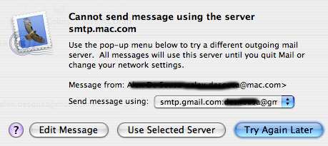

Nobody seems to have asked what's actually happening. Are you getting an error message as soon as you try to send? Are the messages bouncing back? Are they appearing to send and not ending up at their destinations?

Good point, sorry. I get this message after it fails to send. If I use a different server such as my gmail account it will work, but not under my .Mac account.
