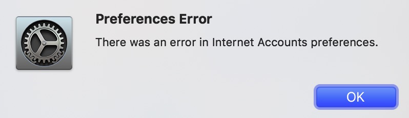

I've been having some trouble today with trying to access my email on Yahoo's servers using Apple Mail.app.
Mac Mini 2018
OS 10.14.6 Mojave
I couldn't connect, so -- on suspicion that there might be something corrupted with my existing account -- I went to the Internet Accounts pref pane and tried to delete it, and then re-create it.
Won't work.
If I use the "internet" preference pane, I enter the relevant information, and then...
... I get this:
I tried deleting the plist file:
com.apple.preference.internet
No good.

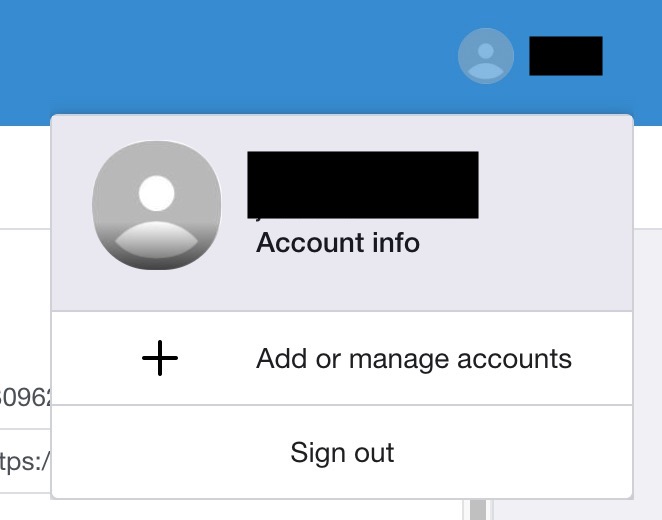

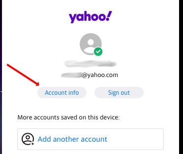

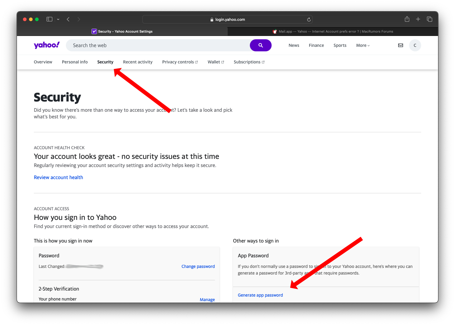

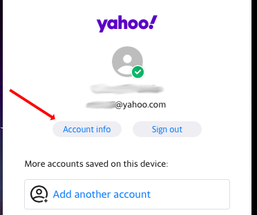

I went back and reviewed the info in this link (posted above in reply 2):
I tried to follow the instructions:
a. Delete your yahoo account... (check)
b. go to your yahoo account in your browser... (check)
c. click on your account on the top right... (check)
d. Click "security"... STOP RIGHT THERE.
In the current Yahoo email page, there is NO "security" button or link there.
Nothing to be clicked:
What you see above is "all there is to be seen".
End of process.
Note: this is not a page -at- yahoo.com.
Rather, email hosted by yahoo (for an att.net legacy account) which is accessed at the website
currently.com
But I checked using a xxxx@yahoo.com address I also have, and it wasn't there, either.
(apparently, yahoo has "changed something" in the past year or so).

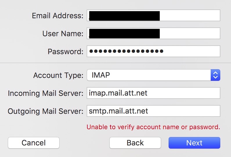

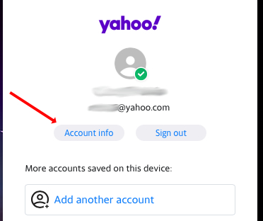

Click on Add or manage accounts, then:
You may be prompted to login before the following steps.
Thanks for the suggestion (I tried it), but...
nope:
Looks like for anything that is accessing the yahoo email servers, you MUST use the internet accounts pane.
And -- at least for Mojave -- that no longer seems to be working.
(as noted in reply 3 above, things still work with later versions of the Mac OS)

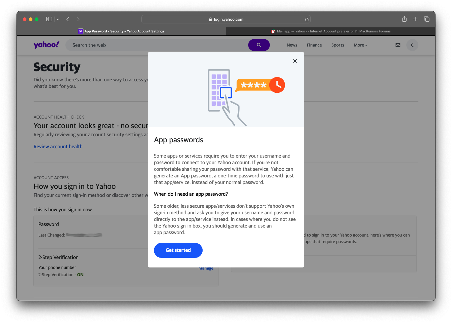

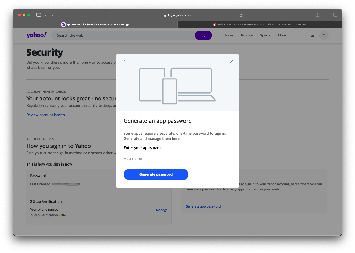

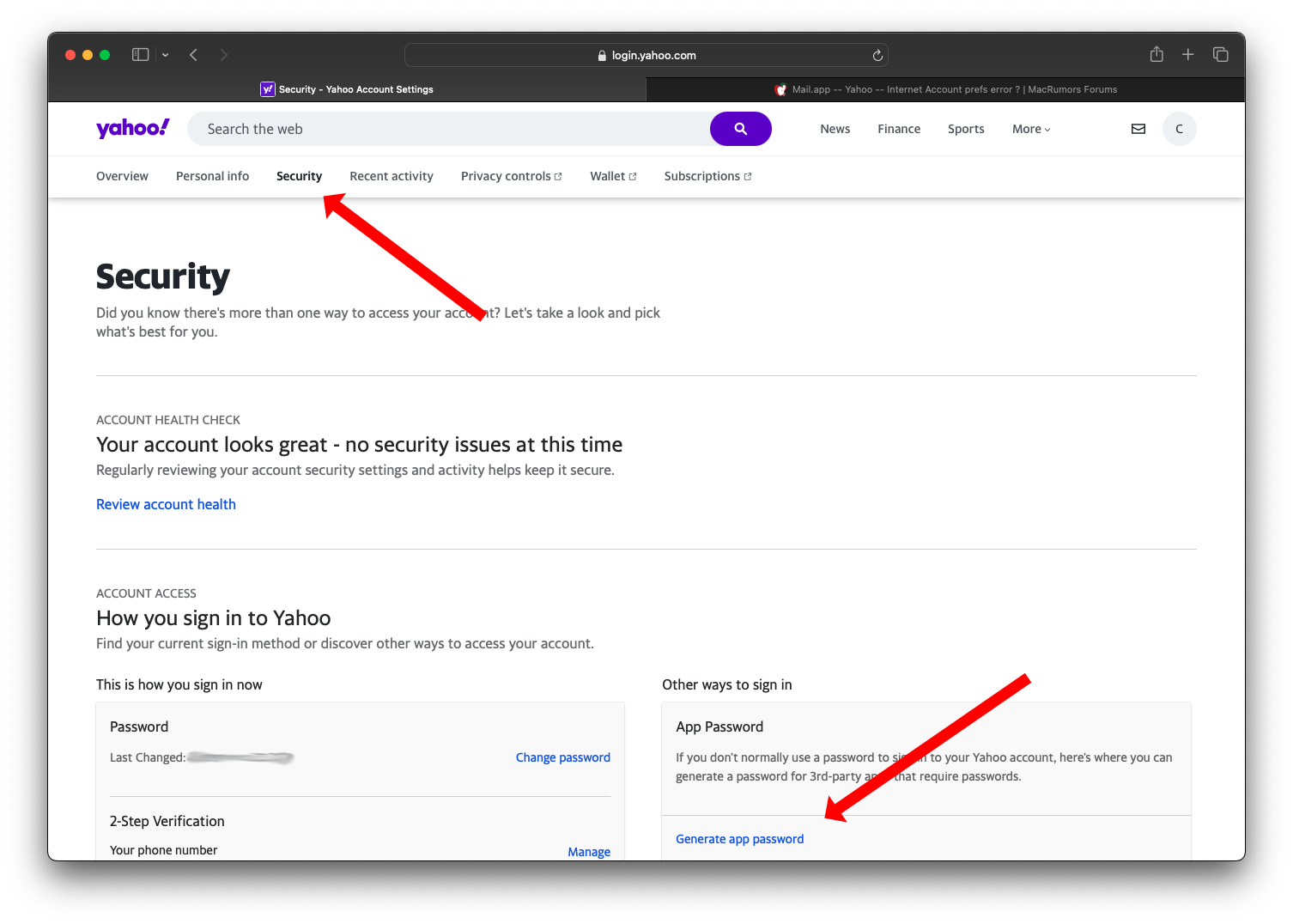

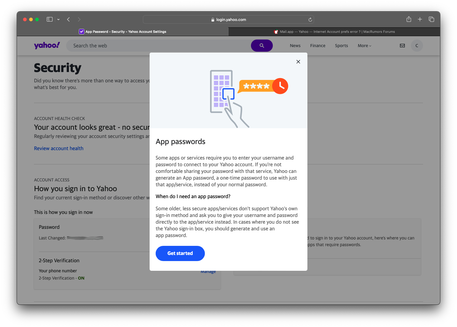

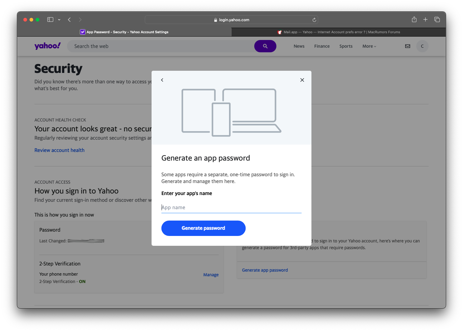

I went back to this URL:
... and was able to get to another (ATT) page which was able to generate an "app specific password".
I then went to the Internet Accounts pane (system preferences), and clicked "add other account" (rather than trying the preset choice of "Yahoo!").
I was then able to use app-specific password which (after an interlude with the spinning beach ball) actually seemed to "break through" and bring up a new (actually my old) account.
It took more than one try to work through this process and get it right.
The app-specific password ends up being something like "cbbshukdowmwx".
Not sure how this will affect "regular" passwords used when signing into a web-based browser.
Or... the fact that on my MacBook Pro 14" (running Sonoma), my "password" when using Mail.app is completely different. We'll see.
Of note:
I had success once, then tried logging into my att account from a web browser, and went back to Mail.app -- only to find that it would no longer connect as it did a few minutes previously.
So... I went back to the URL above, got logged in, and now saw an option to "delete" a previously-installed app-specific password, which I did, and then created a new one.
It's holding and working.
So far...
