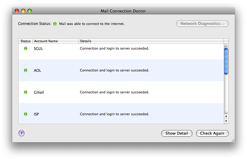

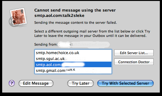

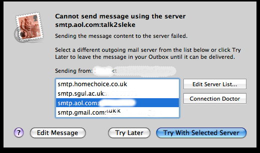

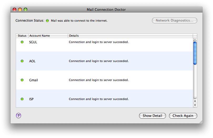

I've been troubleshooting this for over an hour now. My AOL account wont send msgs only receive them. Everytime i try to send i get the error below, i run a diagnostic and mail says it connects with the server fine but sending messages is a no go area.

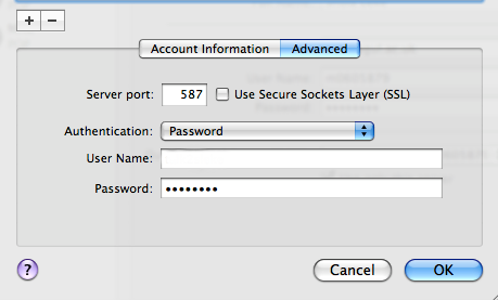

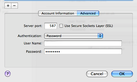

I've quadruple checked the settings and they seem fine. Any idea whats going on?
PS the username space isnt actually empty i've just blurred it out

huh?
I think it's trying to tell you to get a real email account.
What ISP do you have? Are you sure they don't require that you use their server?
Nope. Gmail and my work email all work fine as per normal AOL is the one with issues
Try SMTP server Port 465 instead of Port 567 and check Use Secure Socket Layer (SSL). If this does not work, then download and run AOL Service Assistant.
Didnt work...guess i'll have to use another outgoing server or delete my aol account all together
