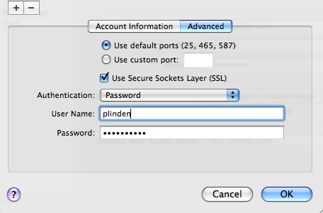

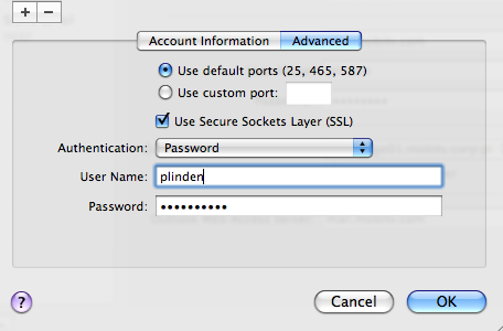

I just had a look at reager.no and smtp.reager.no, and they are different IP addresses. But I see you're able to connect using reager.no from Terminal (I can't - must be some frontend firewall blocking going on for non-Norway IP addresses)
Can you post a screen shot of your smtp server edit pane? Are you using password authentication? With SSL or without? I'm including a screenshot of one of my account's setup page (no, there's nothing there that anyone can use - I altered my login name)
You should also try Thunderbird - just to test out its IMAP. It authenticates using exactly the same method as Mail. If it works with the same settings, there is indeed a problem with Mail.
Personally, the only time I've had problems with Mail is with Exchange servers, and only if the admins don't have IMAP enabled on it.
