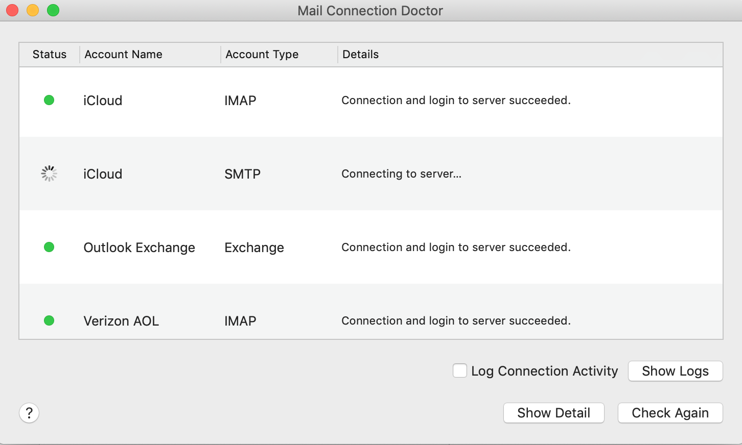

CONTACT APPLE SUPPORT. Its the only way we can get their attention. My outgoing emails are delayed by 10-15 minutes and sometimes timeout.
Here's my Mac mail connection doctor.
Update: Apple now lists this as an issue on their status site. And I just sent an email and it worked quickly. I guess it will be fixed shortly
